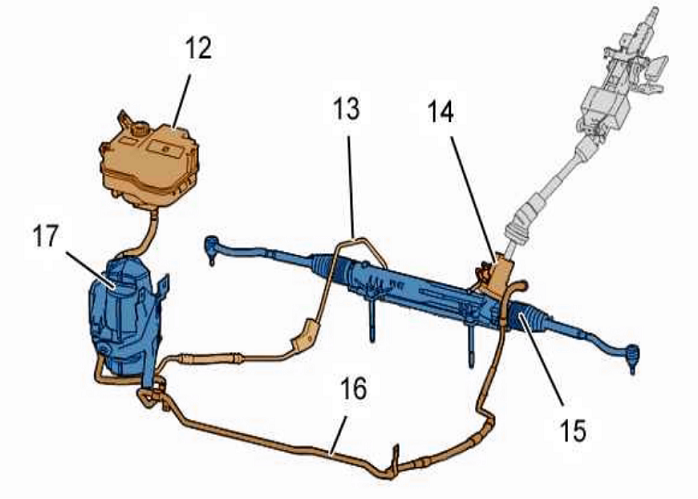

Re: C5 2.0 hdi 55 reg power steering problem
The power steering pump is located behind the right hand wheel arch near the front. You'll need to remove the right hand wheel and the arch liner to get to it.
(12)LDS fluid reservoir.
(13)High pressure piping.
(14)Distribution valve.
(15)Steering mechanism.
(16)Low pressure piping.
(17)Power steering electropump assembly.
The flow provided by the power steering electro-pump varies as a function of the following parameters :
Vehicle speed
Speed of turning the steering wheel
