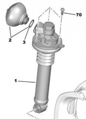

Came across this before and not uncommon . It can sometimes be the o’rings in the strut top.
x 6956
Re: C5 X7 suspension strut fluid leak - Replacement mini guide page 2
There are no 'O' rings on the X7 struts unlike previous models as these struts are bonded rubber to metal. The only 'O' ring is on the Suspension Sphere thread (3 on the diagram) and if it had been leaking in that area, there should be a pool of fluid on the top of the strut mounting seen in the engine bay. Unfortunately when these struts go, they need replacing, unlike series I and II.
