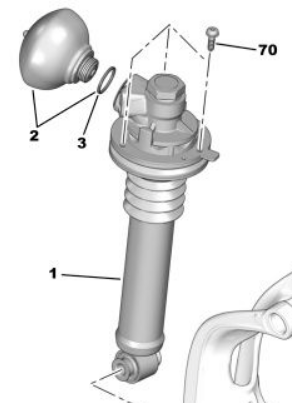

Re: C5 X7 suspension strut fluid leak - Replacement mini guide page 2
There are no 'O' rings on the X7 struts unlike previous models as these struts are bonded rubber to metal. The only 'O' ring is on the Suspension Sphere thread (3 on the diagram) and if it had been leaking in that area, there should be a pool of fluid on the top of the strut mounting seen in the engine bay. Unfortunately when these struts go, they need replacing, unlike series I and II.

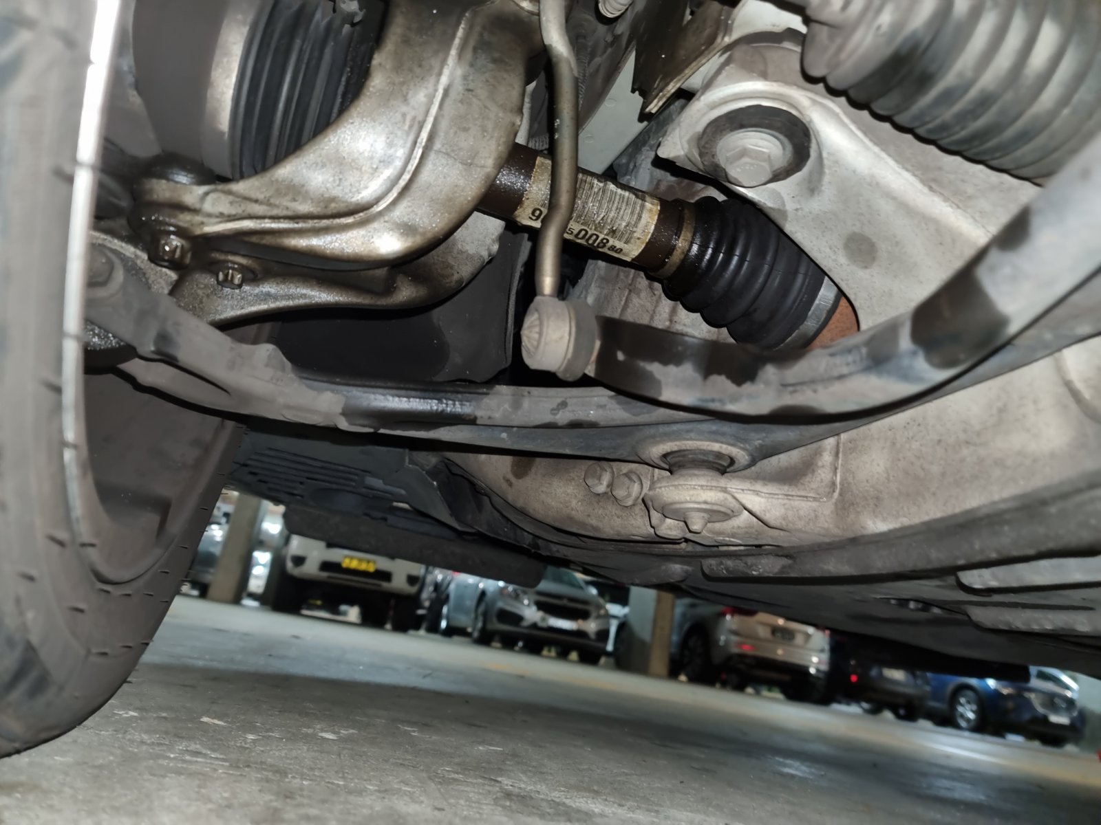

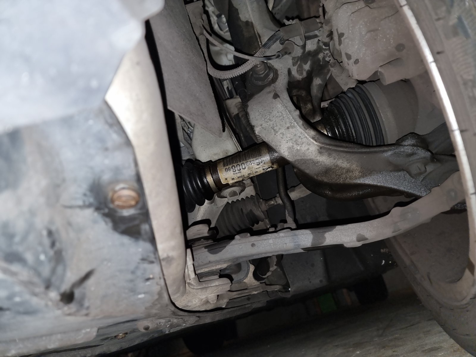

Hi Folks,
I am a new member here from Sydney.
I just bought a used C5 2009 xclusive 2.0 ltr diesel last week.
When I gave it for service today , my mechanic told me there are leaks found on the passenger side of the front suspension. And the suspension needs to be replaced :'(
However I dont notice any kind of leakage on the floor. But as shown in the pictures can see traces of oil on the strut or suspension.
Is this something I need to worry about or can drive without any worry if its not leaking ?
I take my daughter in the car and worried ever since if the suspension will fail in the middle of the road during holiday seasn.
I found this thread matching to the issue I am facing.
Please respond with your valuable comments.
