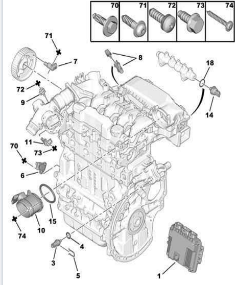

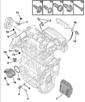

No matter, it's the same sensor and in the same position - number 7 in the diagram:

Re: Xsara Picasso 2007 1.6hdi camshaft sensor
This is just the parts diagrams from PSA. I’ve just screen shot them for you, they are not downloadable.

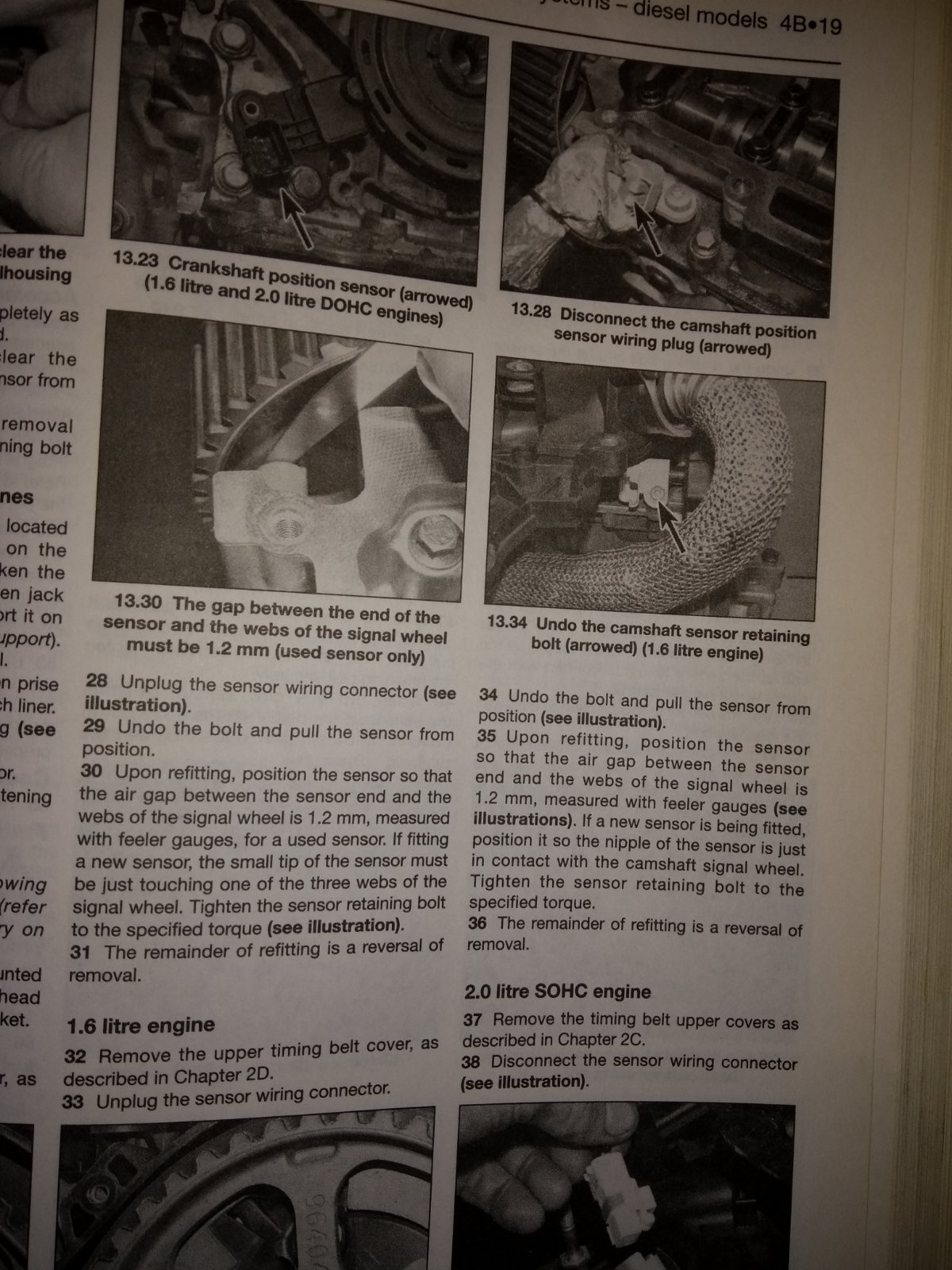

Hi. How do I actually get to the sensor,??
Forum Treasurer
Posts: 12596
Joined: 07 Aug 2002, 17:12
x 1489
Unread post by RichardW »
I suspect it's not as easy as Haynes makes out.... :rofl2: That is going to be well buried under the scuttle, and is on the back of the engine. The Cit manual suggests putting a 9.5mm drill between the sensor and the timing belt cover, which probably removes the need to take the timing covers off (which requires removal of the engine mount IIRC....). What makes you think it needs a new sensor? It's only used at start up to check the synch of the cam and crank AFAIK....
