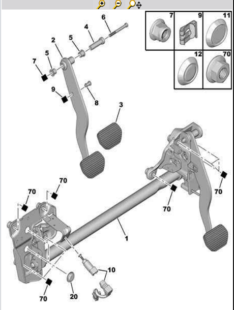

That is correct - it is the hangover from the RHD / LHD conversion and that is where the brake switch is located as you can see from the diagram (part 10).

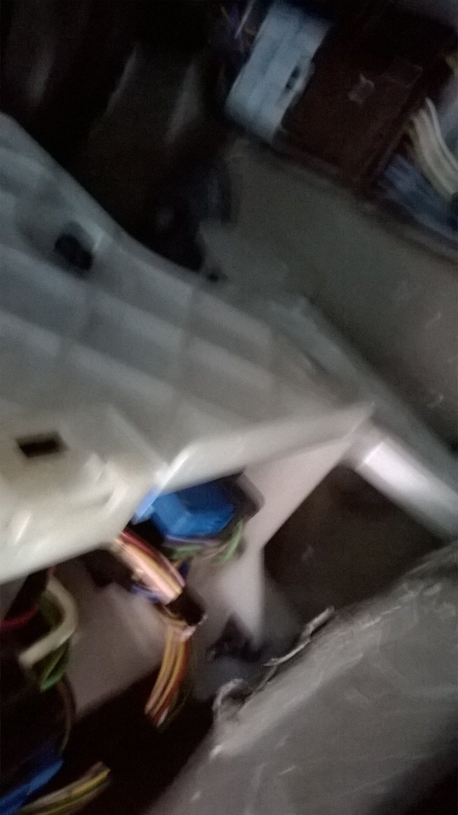

Hello - I'm new and had the same problem. Managed to fix it -- it was indeed the relay -- couldn't have traced it without this forum, so many thanks. It took me 4 hours to change though, as on my car the relay holder faces up and is totally inaccessible. Had to remove the glovebox (massive job) and even then it was a case of reaching fingers over the top of the holder, bending a clip away then eventually easing the relay out. If I could have released the holder from its mount it wouldl have been a lot easier, and may not have needed the glove box out, but I couldn't see how it released even with torch and mirror. I uploaded photo of relay holder. Relay plugs into top of the black holder, (behind the blue one) and is held in by a clip on top which has to be pushed sideways. Good luck.

Thanks for the pic. I was lucky in that I was somehow able to dislodge the relay holder so I could rotate the assembly to pull the relay out.
There isn't much info on this fix so I hope that this thread will continue to help people with the same issue.
