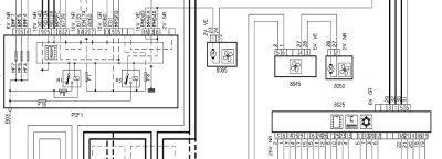

If you look on the diagram below you can see the blower motor control unit. that I have marked in Green (you only have item 3, not item 2). It's possible that it's a cheap part and may be faulty - if in fact he has replaced the right part?
As for the fuse it should be F15 in the BSI module in the car - that really shouldn't be the problem - it will either work or it won't - and as it controls all these functions - I doubt it is that or you wouldn't have these systems working either (not all will be fitted to your car):
| This is the Blower Control Module, Part 6441L2 | Here are examples of a genuine replacement (Valeo) and a cheaper copy |

Ok so that fuse controls the heater panel and the other items I listed -so it can't be the fuse because the heater panel wouldn't have a display and nor would any of the other items work like the radio.haroon88 wrote: 09 Sep 2018, 12:35 Also the mechanic told me that the fuse panel (where the fuse F15 is inserted) under the steering wheel probably needs a replacement or the climate control unit might be causing the problem. Any idea?
The digital heater control panel does send the commands to the blower control module and from there to the blower motor. It is quite unusual for the digital control panel itself to go - but it is not unheard of.
