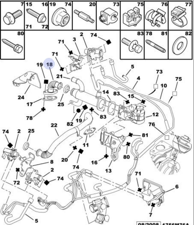

Bad news. That part is not available from Citroen/Peugeot. Only the complete harness. Parts guy printed me the part number for the harness and a copy of an eBay listing from Poland. Dragged his feet when I asked for the Citroen price, I didn't have the heart to insist. I didn't see the point anyway. Lots of money just because you need the £2.00 part it's connect to. Need the car for this weekend so have to find some solution before then.
Many thanks for showing an interest and making suggestions.
Tom.
Tom.
- x 6945
Re: C5 II loss of power CODE P2562
Is the part on the diagram below?
Click to Zoom
Click to Zoom

Thank's Marc. I took a photo of the parts printout when I was at the dealer yesterday. The part numbers on your diagram are slightly different but I think number 10 on your diagram is the complete harness. The actual Y-piece would be hidden somewhere below the number 74. I made a fix last night based on this post http://www.aussiefrogs.com/forum/peugeo ... p0299.html
which has some nice images of the y-piece and the fix I used. Aquarium air T-piece and tubing over the existing vacuum pipes with the stubs of the old Y-piece left in place.
Thanks again for your input. No doubt I will be posting again, hopefully later rather than sooner. The clutch will need replacing so I will try and write something up for that job when I get round to it.
