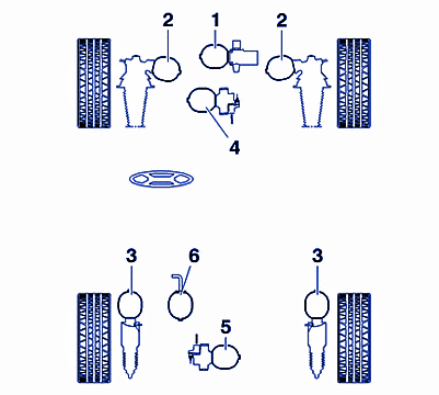

I don't have your VIN, but the XM V6 (ES9J4 Engine) built from RPO 7483 (5th May 1997) has the following sphere types and pressures, so depends when your build date was.
IdentificationVehicle
Type
Diagram
Reference
Suspension
Unit ID
Membrane:
D: Desmopan
U: Urepan
M: Multi Layer
Volume
(CC)
Pressure
(Bars
Damper
(MM)
Main Pressure AccumulatorAll Models196145672D Or U45062 (+5, -32)Without
Suspension Spheres (Front)Saloon
Estate
2962900048M45040 (+5, -15)0,7
Suspension Spheres (Rear)Saloon
Estate
396222871D40030 (+5, -15)0,6
Front Suspension RegulatorSaloon
Estate
496281798M45070 (+5, -25)1,25
Rear Suspension RegulatorSaloon
Estate
596238950D40040 (+5, -15)1,25
SC/MAC Storage Battery
(Anti Sink)
Saloon
Estate
696198613D40050 (+5, -15)Without
Reference Diagram
