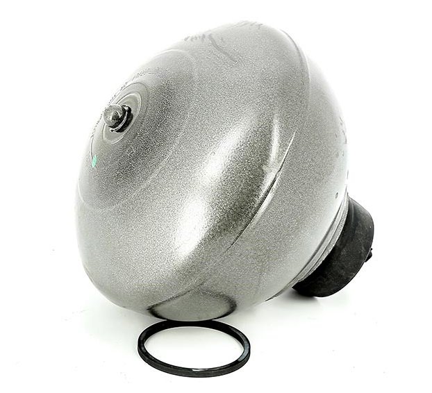

Bryan, are you sure the spheres were "regassed", and not just replaced?
If they have been regassed, each sphere would be fitted with a chromed Valprex valve (with a green plastic protection cap) screwed into their tops, instead of the factory-original blanking cap (plain round thing, about 16mm diameter).
If you do have the Valprex regassing widgets, regassing them again might be an option, if the spheres are still intact and haven't been run flat, although 10 years is pushing it by a factor of about two!
If any of the spheres are of the later grey flatter "saucer" type, they cannot be regassed, only replaced.
Do let us know VIN number, in any case.

white exec wrote: 30 Jul 2018, 16:03 Bryan, are you sure the spheres were "regassed", and not just replaced?

I definitely think they were regassed rather than replaced & they're all the green ones.
I want to replace them now for longevity of the membranes etc., especially the back ones as they're getting quite hard now.

If regassed, they will have a valve at the top, and not a round green stopper. If there's a valve there, re-gassing is an option, but if the spheres are really old (5 years+) then probably best replaced.
