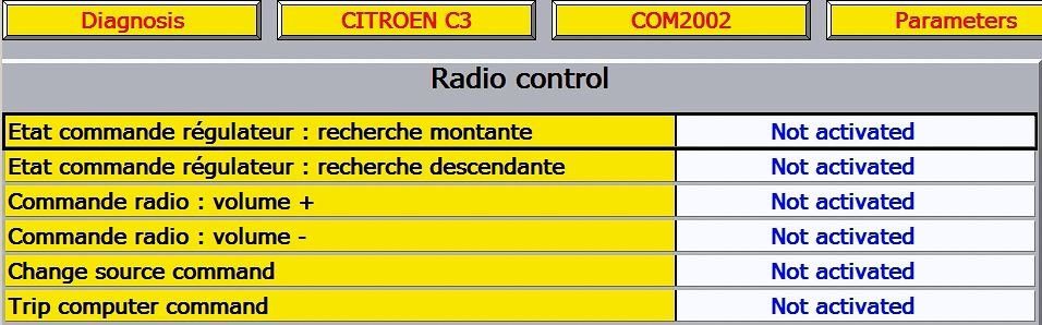

Checking the RADIO CONTROL configuration in COM2000 I'm shown this. Zoot alor!

Ignore that last lexia screen Mike - it is normal for none of those functions to be active on that model.

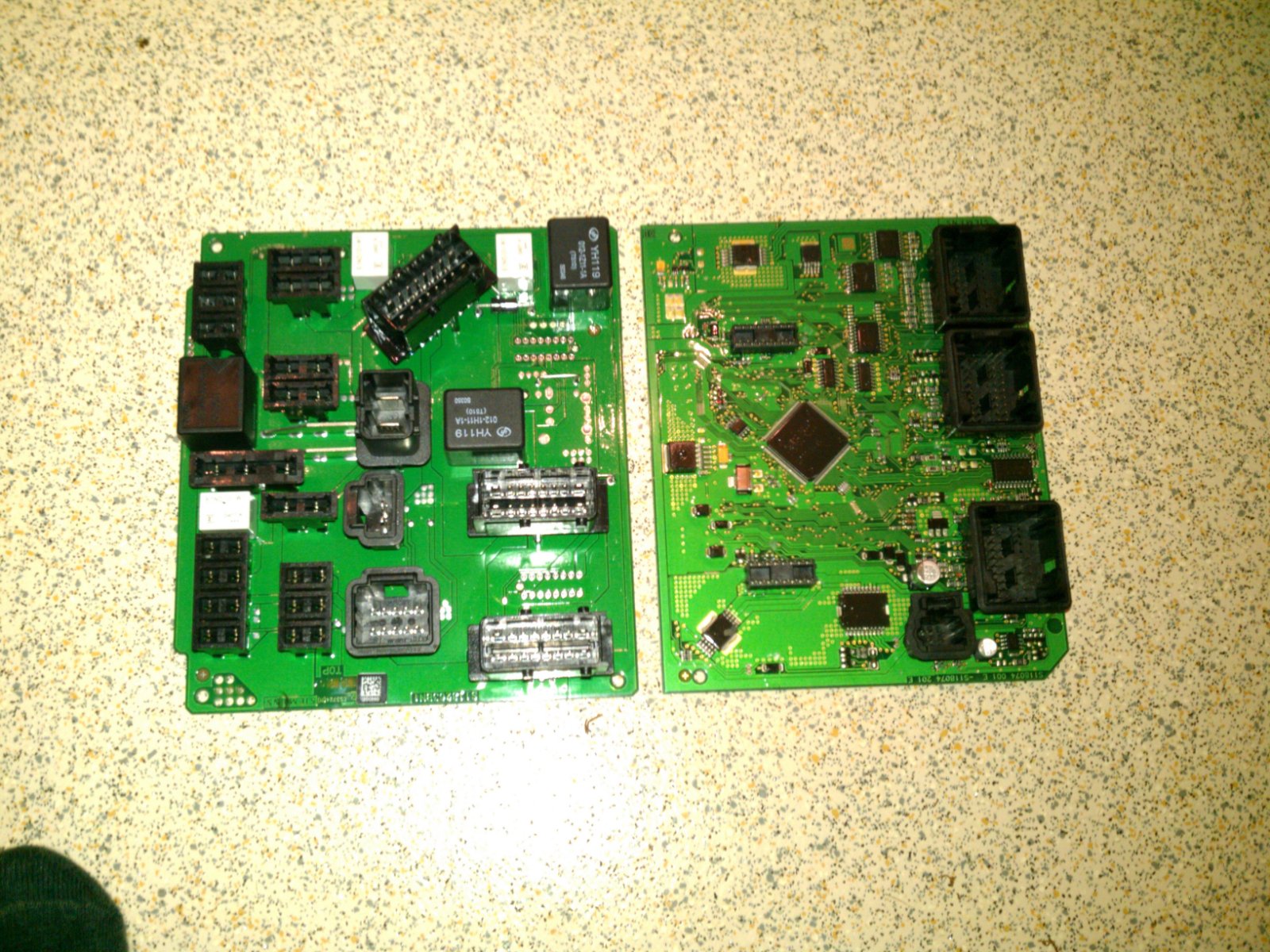

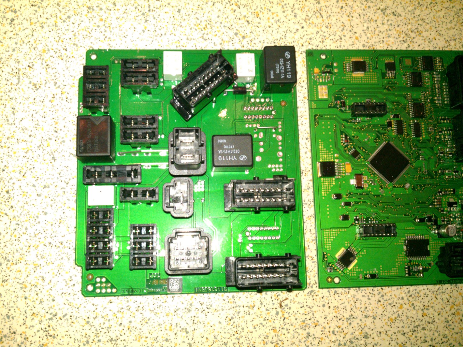

I've not been well enough to revisit this car until today.
Following the BSI fault theory, I've removed the BSI, split the box and seperated the two boards.
Here they are side by side
SIEMENS BSI F01 00 HG
And this is the board we're interested in, the power/relay board
Seperating the boards gives me access to test suspect components - in this case, the relays (as shown in the wiring diagram from Marc)

And we have a winner. In the last photo, top right, relay marked YH119 has an open circuit on the solenoid coil.
