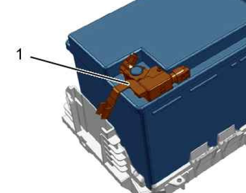

Yes, the good old economy mode is really there to help you not get into a situation where the battery has insufficent power to start the vehicle by managing certain functions and shutting off power to some non-essential devices. On a lot of X7s (and other PSA vehicles) the battery negative terminal is fitted with a BCSCU (Battery Charge Status Control Unit) as shown below:
The main function of the battery state of charge unit is to calculate the state of charge of the battery and to transmit this information to the built-in systems interface (BSI) in order to refine the activation of the energy economy mode.
For the technical aspect in case anyone's interested:-
The battery charge status unit is connected directly to terminal - of the battery and powered by terminal + of the battery.
System standby/triggering
Mode: Rest
In this mode, the battery charge status control unit does not carry out any operations; it is in a minimum consumption mode. The LIN is deactivated.
Mode: Local triggering
In local wake up mode the battery charge status unit carries out measurements, calculations and parameter saves in order under some conditions to reset the battery charge status parameter.
Periodic local triggering (activated by the real time clock)
The battery charge status control unit is fitted with a real time clock which allows it to be triggered periodically. Local wake-up periods of the battery charge status unit:
The battery charge status control unit is triggered locally when the battery current falls below - 500 mA (consumption on the network higher than 500 mA) or when the battery current is higher than 50 mA (current charged in the battery higher than 50 mA).
Mode: Active
The "active" mode is validated unconditionally when the LIN is activated (communication on the bus).
The battery charge status control unit is triggered with a delay of 0,276 second following the initialisation of communication activated by the BSI.
The battery charge status control unit becomes dormant following a delay of less than 1.3 seconds following the disappearance of or the request to stop communication on the LIN.
Triggering of the BSI following a drop in the battery charge status
When the vehicle is on standby, the battery charge status control unit can attempt to trigger the BSI each time the battery charge level drops by 10%.
Triggering attempts counter BSI
The "triggering attempts counter" parameter permits counting of the number of unsuccessful triggering attempts generated by the battery charge status control unit.
N.B. : A triggering attempt represents 6 successive unsuccessful triggering requests.
