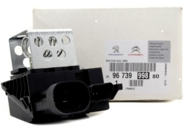

I would always suggest getting it diagnosed first to check the fault code (if any) before replacing parts - however, I have heard of a few cases where the fan was running on high speed at start up and replacing the Fan Cooling Resistance unit has cured the problem.
The fan cooling unit is number 6 on the diagram:Fan Cooling Electronic Unit (with Resistance)
Part number: 9673999880. Eurocarecar do one for £33:
https://www.ebay.co.uk/itm/9673999880-R ... 2587889273

UPDATE:
Went to the dealer, it was the part mentioned above.
