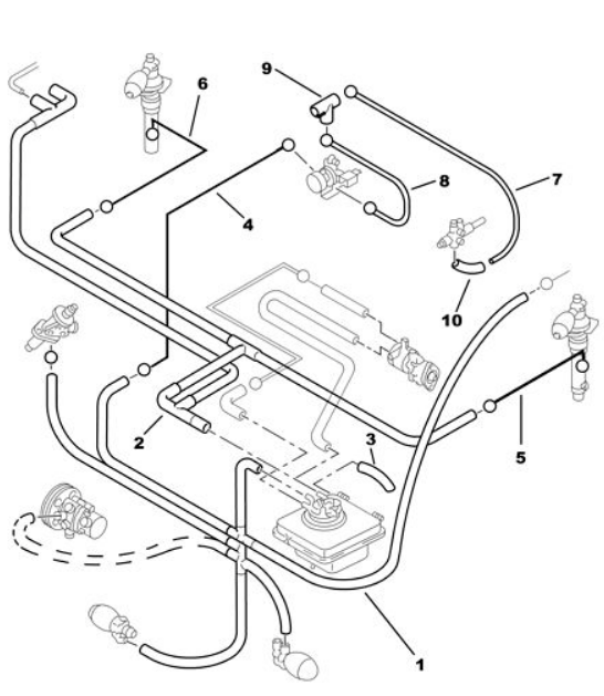

Re: Xantia S1 hydro leak what is it ???
Could be part 12 on the diagram which is the 3 way union. Parts 7 and 9 are the oil return pipes.

- x 1751
#9 is the return from the height corrector, #7 looks like the return from the hydraulic pressure (safety) switch, so I'm guessing that the third pipe will lead back to the hydraulic reservoir.

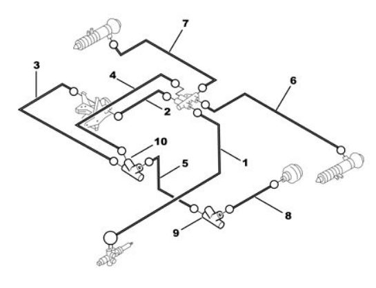

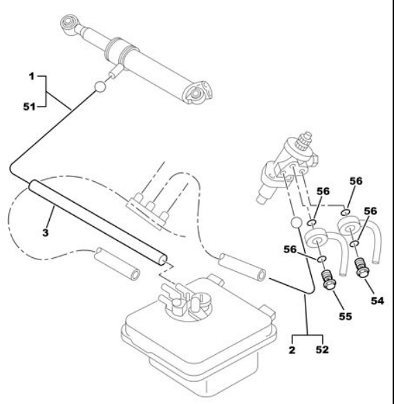

- x 6957
Ok, so here are all the hydraulic supply and return pipes, including the Power Steering for your specific Xantia.
If you want to know what the specific pipes are, let me know the Diagram (A - F, followed by the part number on the diagram).
