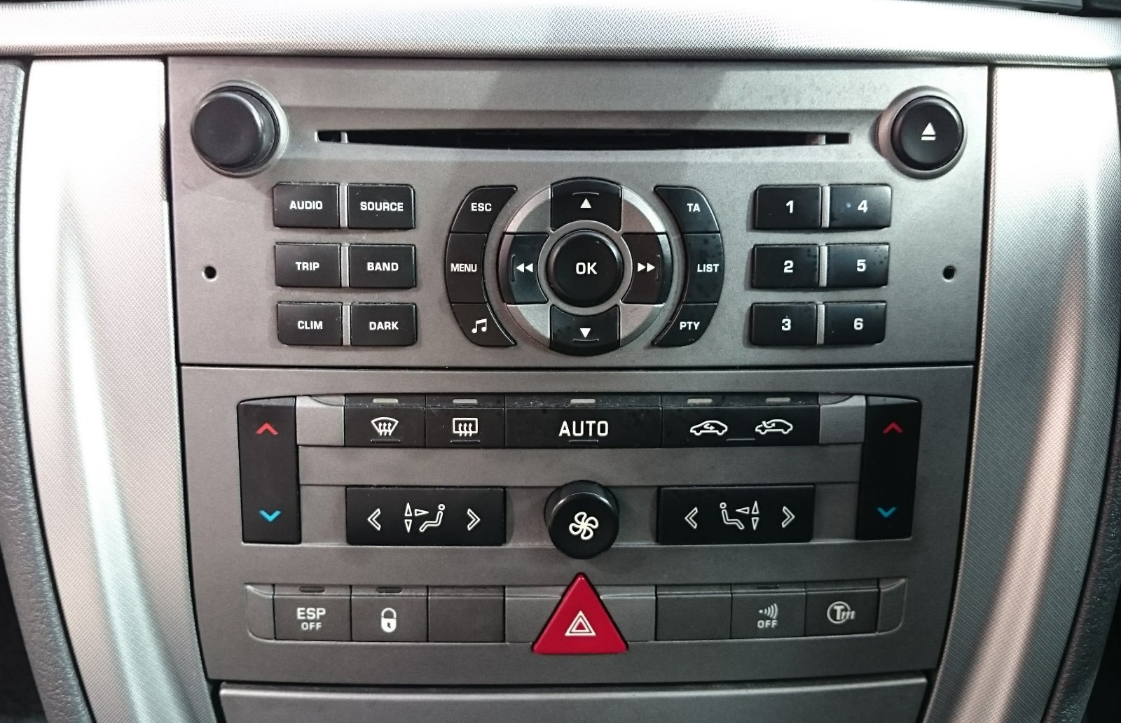

Be warned that this head unit is not just a radio - it also interfaces with the car systems and configures certain car options and functions - so I do NOT recommend you remove it!
The models this early do not support any bluetooth or USB. This head unit does support a CD-Changer than can be used to play files from a third box like Yatour or similar, but will only mimic a CD-Changer. You will have to organise files into a max of 6 folders (CD1-6) and each folder can have a certain number of tracks in.
This unit is an older RD4 system - so Google Yatour and you will see some example options.
For further reference, you have the dual zone climate control system. Just keep it on AUTO and the temperature for the driver and passenger can be adjusted using the up and down temperature arrows on the relevant side. The system will do the rest.

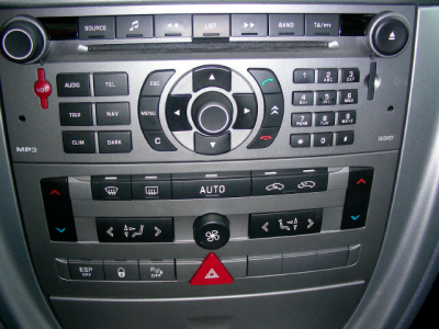

Just looking at the photos on both Takshaka and Mike T posts, my head has the buttons set out differently. Where they have Band I have TEL, and where they have PTY I have BND, there is no PTY button.

Yes that will be a different head unit - the PTY function is shared with the TA Button top right.
This is the RT3 telematic unit Gibbo that I had on my MK II:
