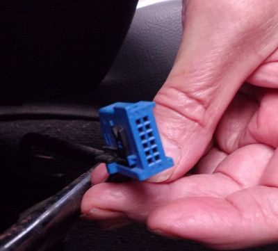

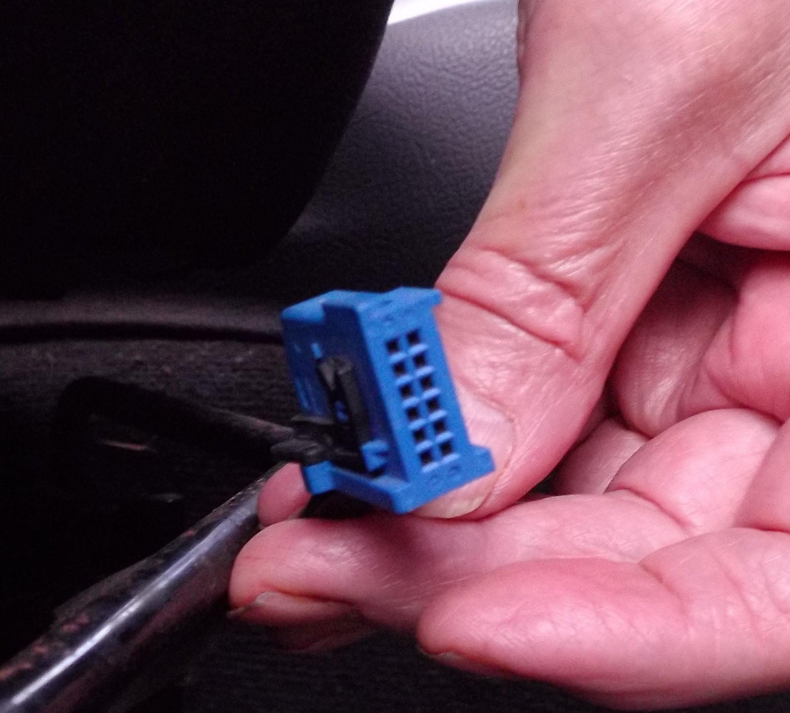

You have me thinking now Marc, my car has the under seat plugs for a CD changer so I assume it's already plugged into the back of the head unit, could the Yatour device plug in there instead of into the head?
- Posts: 42019
- x 6955
Re: 2006 Citroen C5 audio system
I'm not sure whether the CD Changer cable under the seat will be Male or Female Gibbo - I believe it has a Female to the back of the head Unit, but couldn't say for the changer end...
- Posts: 8186
- x 2943
This is it:
- Posts: 42019
- x 6955
Ok, so that might be promising Gibbo - and another way of having the Yatour tucked away under the seat for the OP, assuming he doesn't have the CD-Changer already installed.
And on that point, if you do decide to go for this option, and DON'T already have the CD-Changer option, you will need to activate the function using Lexia or find somebody who has one near you, as it needs to be activated in the car's computer system first.

- Posts: 8186
- x 2943

I have a Yatour box now but have yet to get it installed. The cd changer connection under the driver seat is unfortunately female (as is the yatour connection) so I can't use that unless it is possible to buy a male/female adapter for this type of connection. Does this type of connector have a name or is it unique to this device?
