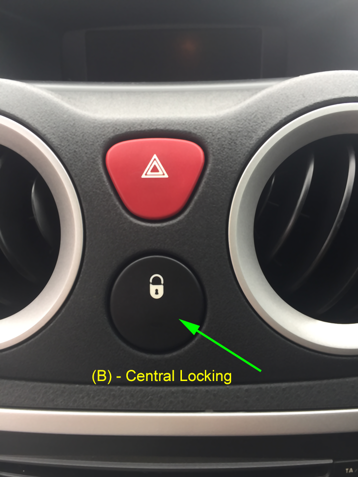

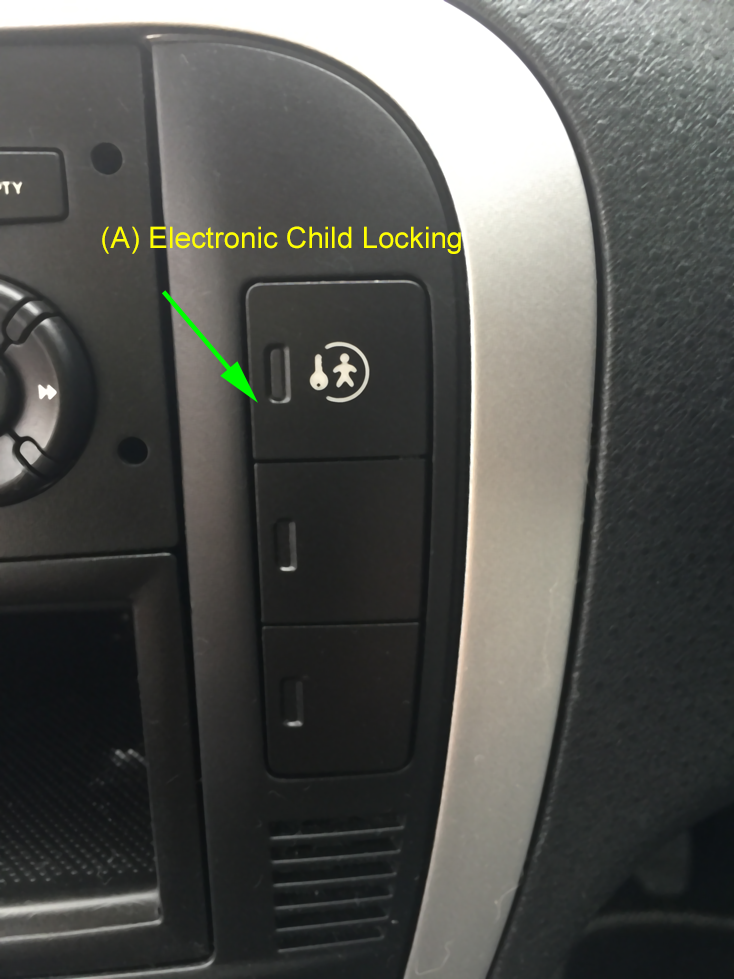

I just need to understand what is going on:
Just to confirm the controls - as the 'Child Lock' button as shown below should not have anything to do with locking the other doors - are you getting these mixed up?
The above is on a 2007 model Exclusive, but if you have the electronic Child Lock function the button will have a similar picture, but may be located elsewhere.

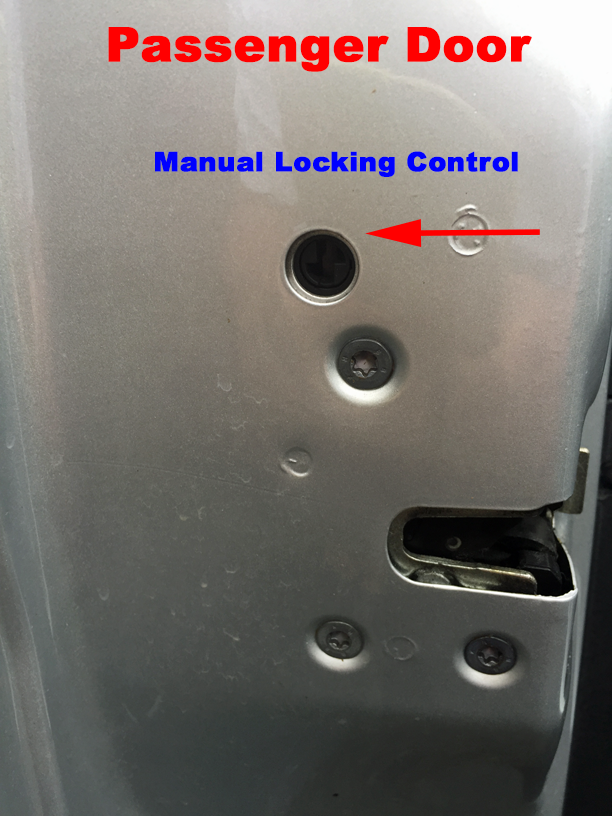

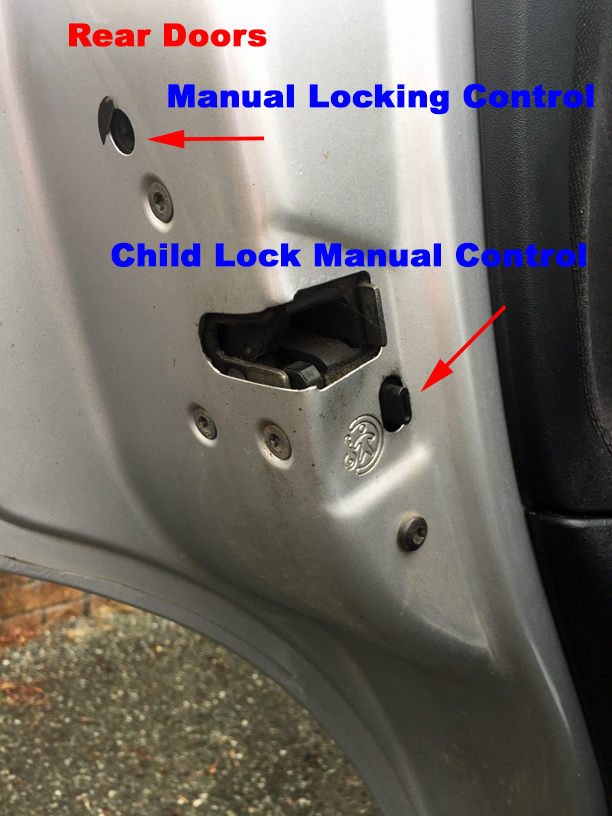

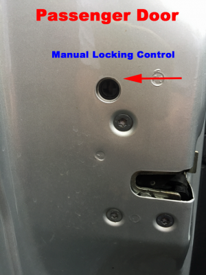

With the C3, locking with the key will only lock the driver's door. In the event of Central locking failure, you need to peel back the black tape covering a hole on each door and rotate the control using a key or similar to lock the door manually when shut - when Central locking functionality is restored, it should revert to normal locking and unlocking.
I'm not saying this is your issue - but it explains the system to lock and unlock manually in case you need it.
As for the Aftermarket Stereo:- The RD4 system is more than just a radio - I'm blue in the face from discussing this on various other posts - it is also the control interface that enables and disables the car's functions and some of the options - like diagnostics, reverse wiping in reverse, auto lights, guide me home, etc. etc.
The question is has anyone changed any settings in the BSI when the aftermarket radio was fitted? You would need Lexia to do this.
If there is a sticking / failing door lock actuator, it may need some attention - but this won't account for this happening simultaneously on all the doors.
In either case, I would get it hooked up to Lexia and see what it is not happy with. Lexia will be able to determine any faults and test the actuators. If there is an electrical problem - that could have been upset by the recent changing of the wiring or connector blocks when changing over the equipment.
| Child Lock Electronic Control This will lock rear doors from inside only when on. | Central Locking Button This will lock / Unlock ALL doors when pressed and when held for a few seconds will activate or deactivate automatic locking when driving off after 6 MPH |
| Passenger Door Lock Manual Control (remove black tape) to lock door | Rear Door Controls Manual Controls for Child and Manual Locking |

But back to your question, the child lock button is different, but its light is on all the time. Pressing it locks the car doors just like pressing the big, round, door lock button. I say doors, but it's only the driver's door that I can open at the moment (so I can't even set the other doors to lock manually!); when I press the child lock button, it remote locks the driver's door and I then have to open it from the outside with a key.

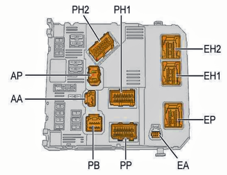

Here are the connectors on the BSI - I have indicated the ones relevant to the locking and child locking system in case you want to check the connections:
'PH2'
'PH2'
- Pin 13:- Door locking output:- Signal type '-'
- Pin 15:- Door unlocking output:- Signal type '-'
- Pin 16:- Deadlocking motors supply output (R.H.D.)
- Pin 30:- Child safety and deadlocking relay output on right hand drive:- Signal type - all or nothing
- Pin 4:- Front LH door open switch input:- Signal type - all or nothing.
- Pin 5:- Front RH door open switch input:- Signal type - all or nothing.
- Pin 9:- Child safety and deadlocking relay output on right hand drive:- Signal type - all or nothing.
- Pin 20:- Child safety activation/deactivation dashboard warning lamp output:- Signal type - all or nothing.
- Pin 27:- Front LH door unlocking input:- Signal type - all or nothing.
- Pin 29:- Front RH door unlocking input:- Signal type - all or nothing.
- Pin 31:- Rear RH door child lock input:- Signal type '-'
- Pin 33:- Rear RH door open switch input:- Signal type - all or nothing.
- Pin 34:- Rear LH door open switch input:- Signal type - all or nothing.
- Pin 36:- Rear LH door child lock input:- Signal type - all or nothing.
- Pin 2:- Rear tailgate opening control output:- Signal type '-'
- Pin 5:- Child safety activation/deactivation output:- Signal type - all or nothing.
