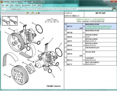

the belt that drives the alternator and hydraulic pump shredded and some bits got wedged in the gap of the pump pulley wheel which is now leaking between the gap, I have an O ring kit that I got from Plaeides for another job on the pump and I am wondering if its oil seal O ring that is leaking, and what problems I might have in replacing it or how to go about it even, any advice would be very welcome.
Many thanks Bill

Not sure if the attachment helps at all but the picture looks self explainable
Husky.

One issue with this job is that the pulley is a tight press fit on the shaft, and a hydraulic press is probably required to remove and refit it.
You should consider sending the pump to Plaeides for refurbishment unless you have access to a very good workshop.
