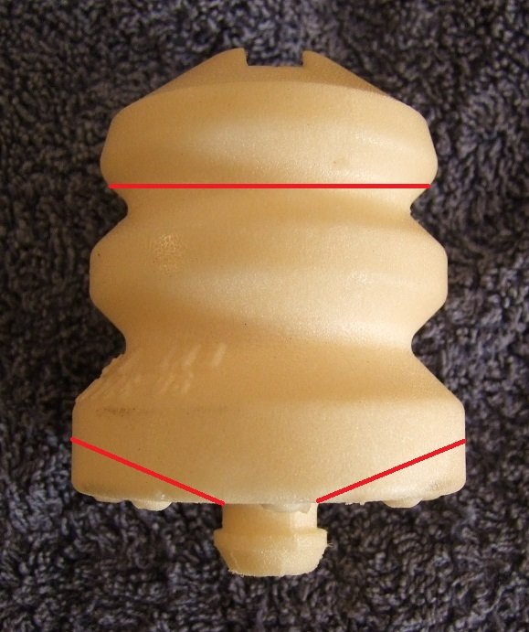

Having searched the web for Xantia bump stop replacements.. I be found that with a small modification, C5 bump stops will fit the Xantia. You need to cut the flat base of the stop to fit the slight v shape of the Xantia, then cross cut the nipple with a Stanley knife, grease it and use a long handled 5mm flat blade screwdriver to ease the nipple, far side first, into the hole. Hope this helps..

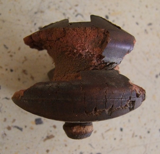

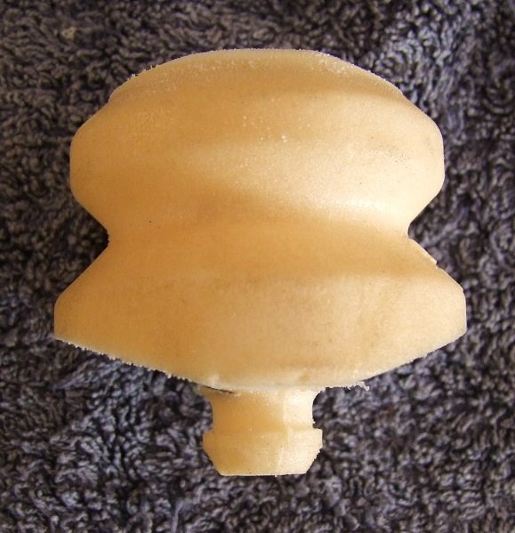

I had to do something similar (in 2015), Chris, for our XM rear bump stops (inside the large circular cross-tube).
The original (5166.52) had crumbled, and was NFP: A C5 item (5166.66) still available, and just needed some trimming of height, top and base-angle: Final result: Other possibilities, still available then seemed to be

That's the v shape I was talking about.. I was a bit too severe with the cuts on mine.. but was rushed trying to get them fitted less than an hour before the MOT. I failed and needn't have worried as they're no longer part of the MOT. At least this is publicised now so others can use the information.
