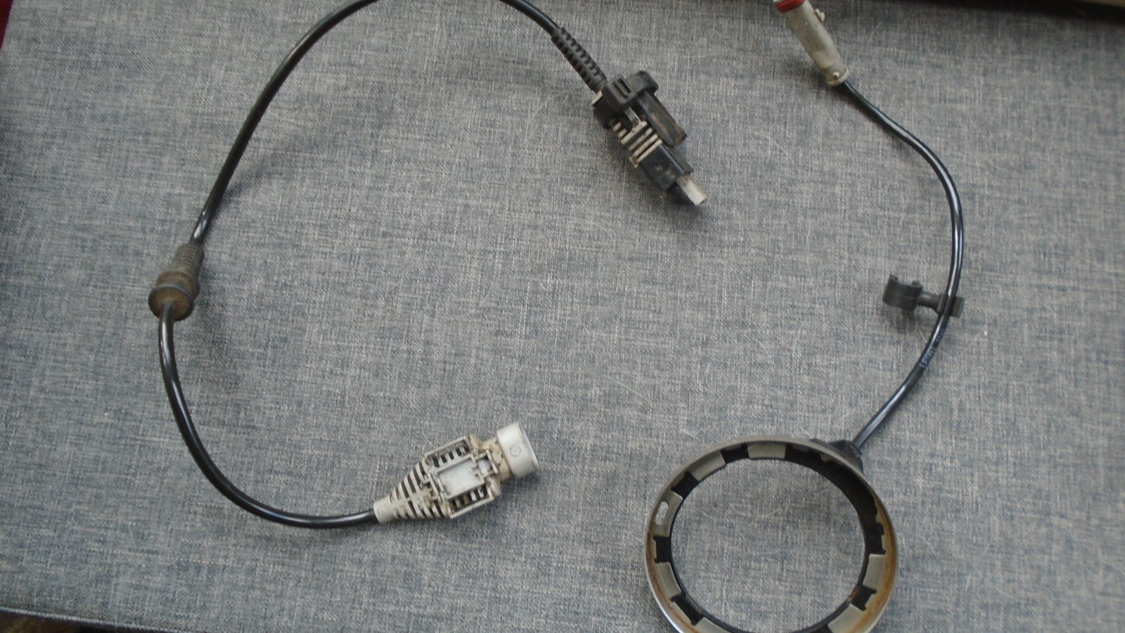

- Posts: 26425
The PITA Electrical Connector
One end of this is well qualified for inclusion in the thread. A 20 minute fiddle to press/pull the right bit to get it undone.
Yes its from the Vectra but by no means unique in the world of PITA Electrical Connectors.
Why the over engineering? Whats the idea of the plastic ridges....cooling fins? surely not. Basically its a two conductor wire, joining onto another 2 conductor wire.
Quite chuffed with myself so far. Got the multimeter out and found the problem with the ABS front right sensor/wiring. Wiring fine from ABS Ecu to under wheel arch connection, ABS hub Sensor fine, and although appearing intact, that intermediate bit of wiring with the connectors either end has no continuity on one of the conductors.

Re: The PITA Electrical Connector
I have to agree with you on the PITA connector engineering. I have got so fed up with them I never waste time if they don't separate straight away. Its out with the cutters on both sides of the connector leaving small tails to identify which colour is connected to which on the bench with the meter and then when refitting solder heatshrink and self amalgamating tape to finish. If I have to break it again in the future its the same procedure. Also it does eliminate dodgy connections like the infamous airbag issue under the driver's seat in Meganes.

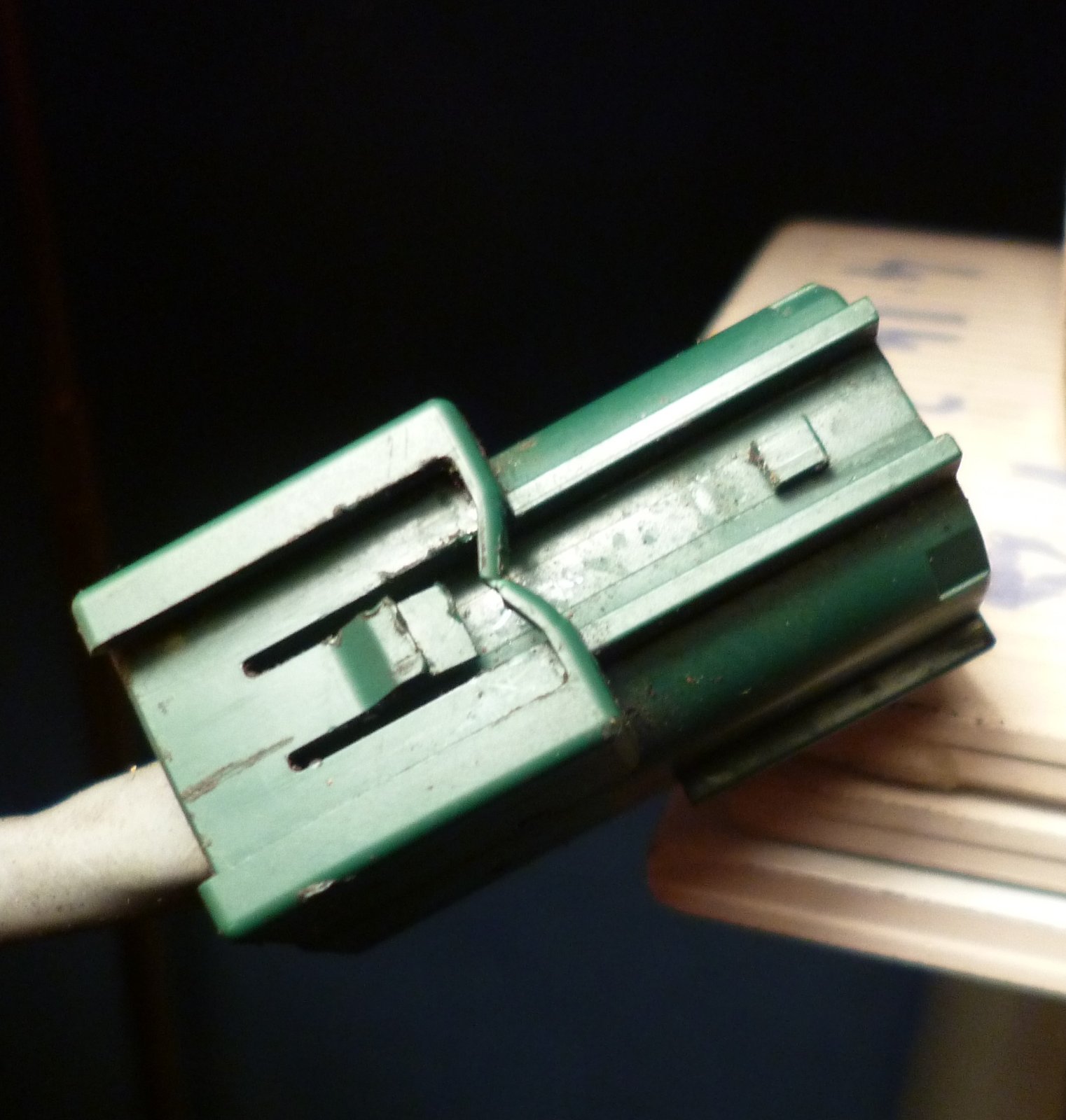

- Posts: 26425
Another example of the PITA Electrical Connector
This one from an O2 Sensor. As well as being of itself a PITA, its at a PITA location. Some may have perfected the one-handed disconnection of a PITA electrical connector.....not me. The only position I found to get 2 hands at it was to lean over the engine bay and stuff a hand/arm down either side of the back of the engine.
Its a bit of a double fiddle press action. The first releases the connector from the mounting, and the second after much fiddling releases the plug from the socket.
