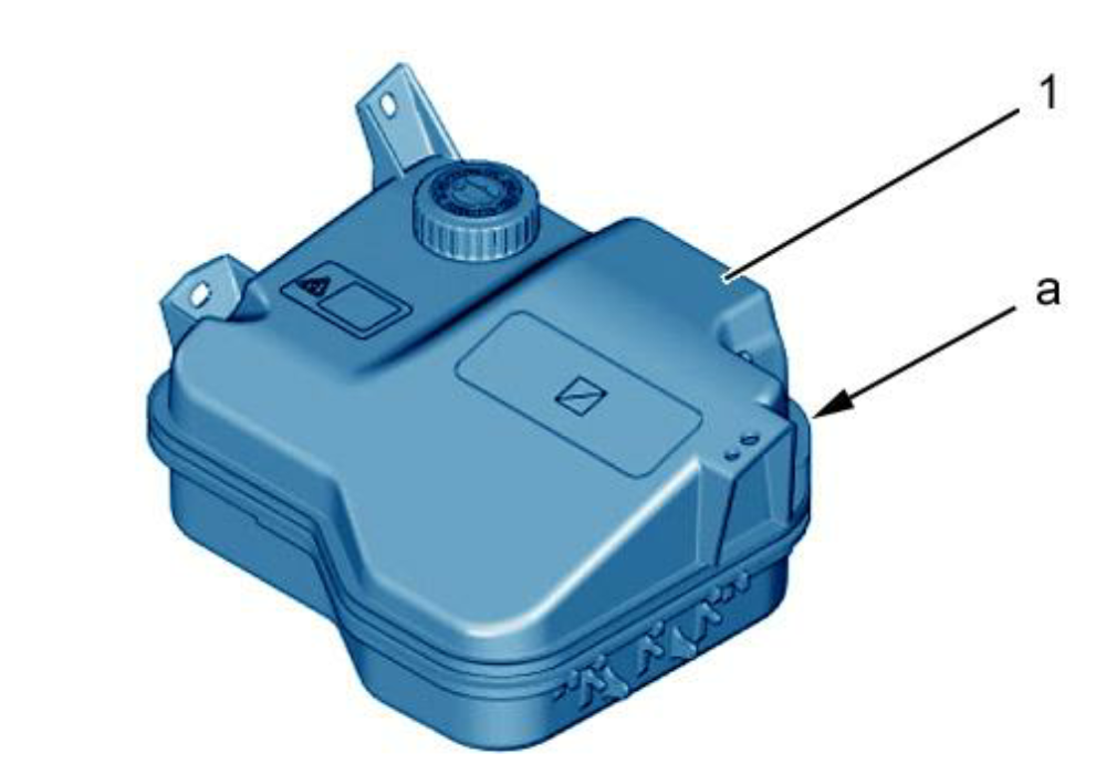

Gibbo, there are many places that the oil can leak from including the collar clamps, o rings and sealing issues - but on some earlier models the LDS tank (which is welded in 2 halves) could develop a leak at 'a' where the seam is, leading to oil ingress and contamination of the underlying motor and the subsequent blowing of Fuse F01. There was a TSB relating to this which clearly details the problem.
Later models from RPO 12174 had a lid fitted with a safety valve to help prevent pressure splitting the tank.
