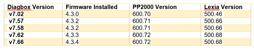

- x 6958
Re: Lexia unable to communicate with ECUs
Hi Harry
It is a distinct possibility. Diagbox will install the appropriate version of firmware (up or down) according to the table below Harry:
Click to Zoom
Click to Zoom
Hi Marc
Excellent little table - all explained very succinctly.
Remembering back 6 years or more when I bought my first Chinese clone, "Scary" installed it remotely as the DVD sent was corrupt.... The VCI was not recognised and he had to lower the firmware so that it would run. I had to smile as the "only a few minutes" turned out to be over an hour. Good job I had no idea what he was talking about then
. (not that I am much better now
Once again, thank you for your expertise.
BTW I am trying to reload the Service.Citroen via the iso file disk images. Tried on Win7 and the program hung on image3 so left it overnight. Appeared to have finished by morning but would not open with error msg implying that file was corrupt.
Then tried it on Win 10 and none of the Disk Images will open. now running chkdsk as admin and hope this sorts out the problem, if any....
Thanks again and regards, Harry
