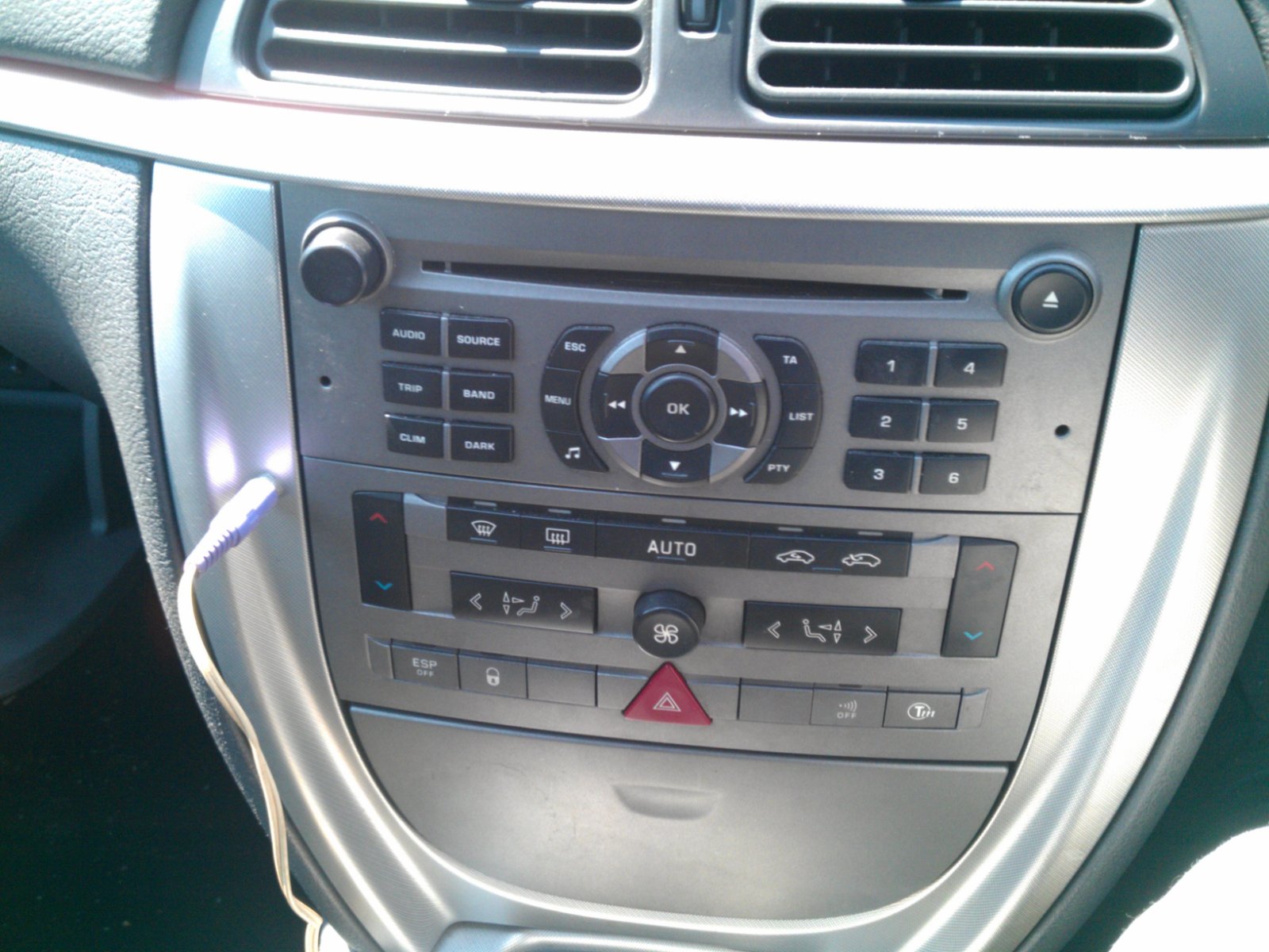

I pulled the centre panel trim off looking for a convenient place to drill and mount my Aux-in socket. In doing so, I noticed a small loose piece of plastic drop down into the gear shift area and on retrieval found it was the missing piece needed to latch my ashtray. I've refitted it and the ashtray - it now stays closed. Yay!!!

I know it sounds trivial, but it really annoyed me having a gaping hole where the ashtray is and it's worth noting, buying a replacement ashtray wouldn't have solved the problem as the part that was missing is fitted to and from behind the centre facia panel.
Anyway, facia trim (with new Aux-in socket), climate control panel, radio and ashtray all refitted so took another gander under the seat and sure enough - again covered in sticky-backed foam - is the harness and blue connector for a CD changer in a fixed mounting tray.
So question is, are there any aftermarket devices that will plug n play there?

The CD Changers for the C5 are very specific and must be CAN compatible. There were 2 types available one worked the other didn't so you need to get hold of this Clarion one:
Part 6564 E1, RP 6564 QK or 9647427980 which are compatible with your car until RPO 10919 (your car is 10168)
Here you go:
https://www.ebay.co.uk/itm/PEUGEOT-CITR ... Swlv9aYw9-
This one has the cassette mechanism too, so make sure you get one with that!

Was hoping there'd be something aftermarket with greater capacity and options etc. I guess the limitations are with the head unit itself.
Still, having re-enabled aux-in, I have more choice now.

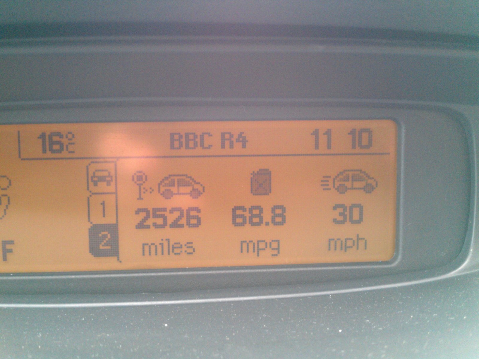

I can make it, I can make it... (Dumbo reference) halfway to the 5000mile accolade
- x 6957
Re: MikeT's C5r 1.6 hdi Estate
The 'BS'-Ometer is about to kick in again I feel....
Just jealous of that MPG - what's the secret ingredient then?
