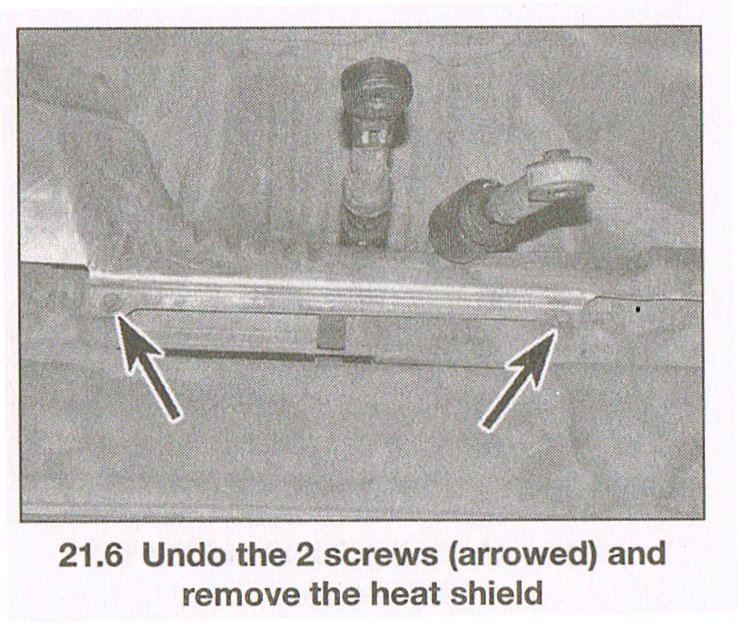

Is it possible for you to point the offending square piece somehow in a drawing or picture, I realise I am asking a lot : )
There was nothing like that square that I spotted today.
Haynes manuals are useful, but it is a bit like spot where this image was taken : )
UPDATE
i located these images for my car, not sure where the fisrt one is.
I think the second is refering to the suspention
God Bless Spiff

Spiff, if you look in my last but one post, with the 3 diagrams in a table, you’ll see that the first one concerns all the heat shield components. That’s what is showing for your car, but remember I have a MK III X7 C5, so it has a few more heat shield components than your car it would seem. I just mentioned it as worth checking, but maybe it is rattling now where you have had to modify the replacement to fit?

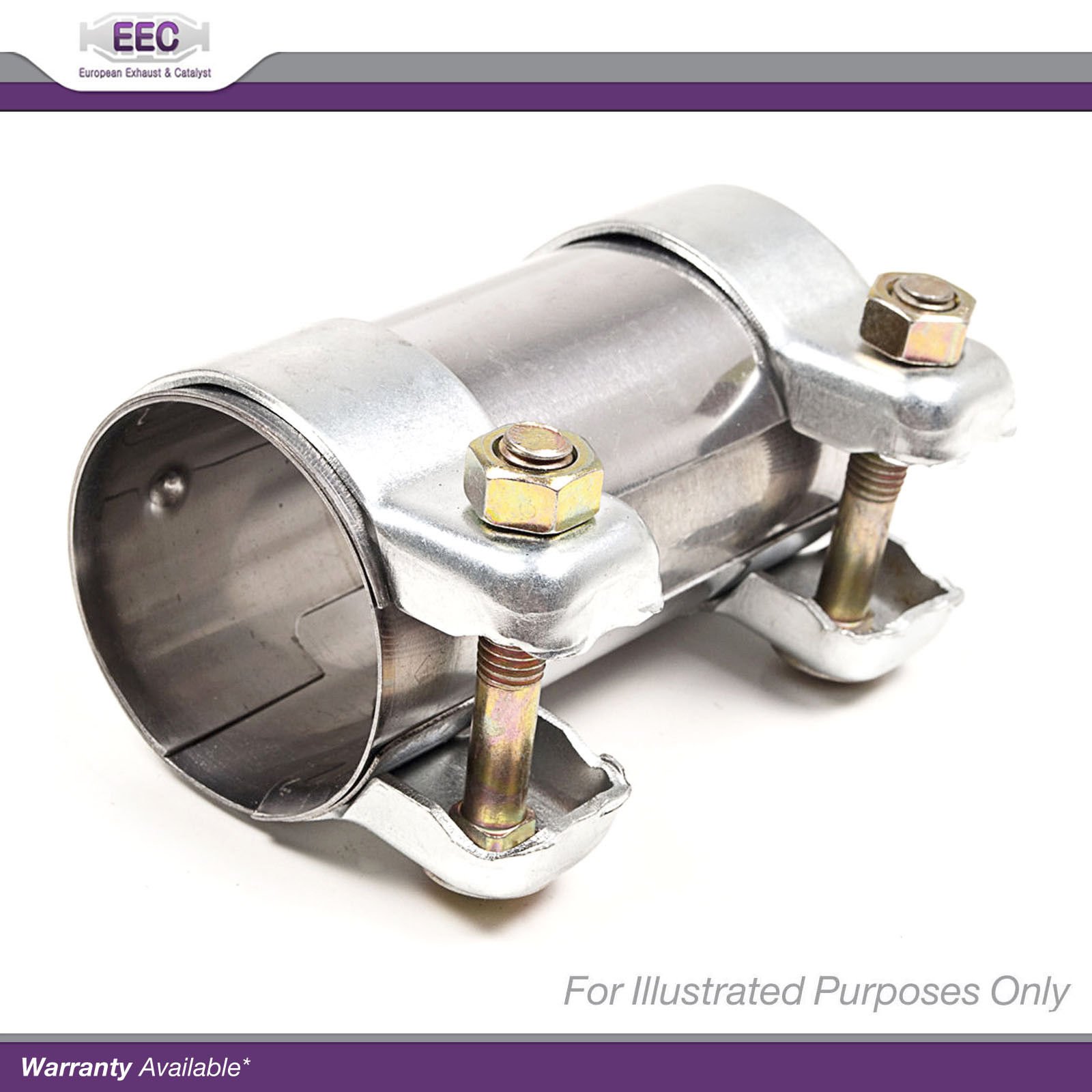

A new pipe joiner is on its way, I once had an exhaust system on a M1 Jaguar ( cost £30 the car that is ) pull off front to back when a clamp caught on low ground.
Strangle enough it was in Cornwall, it happened on rough ground at Rinsey many years ago on holiday down here.
Fortunately I had tools and a set of ramps in the back of the car : )
This clamp will have more room to turn the bolts away from the ground.

The first image has the gear shift linkages - so it's probably somewhere over the sub-frame behind the engine.
