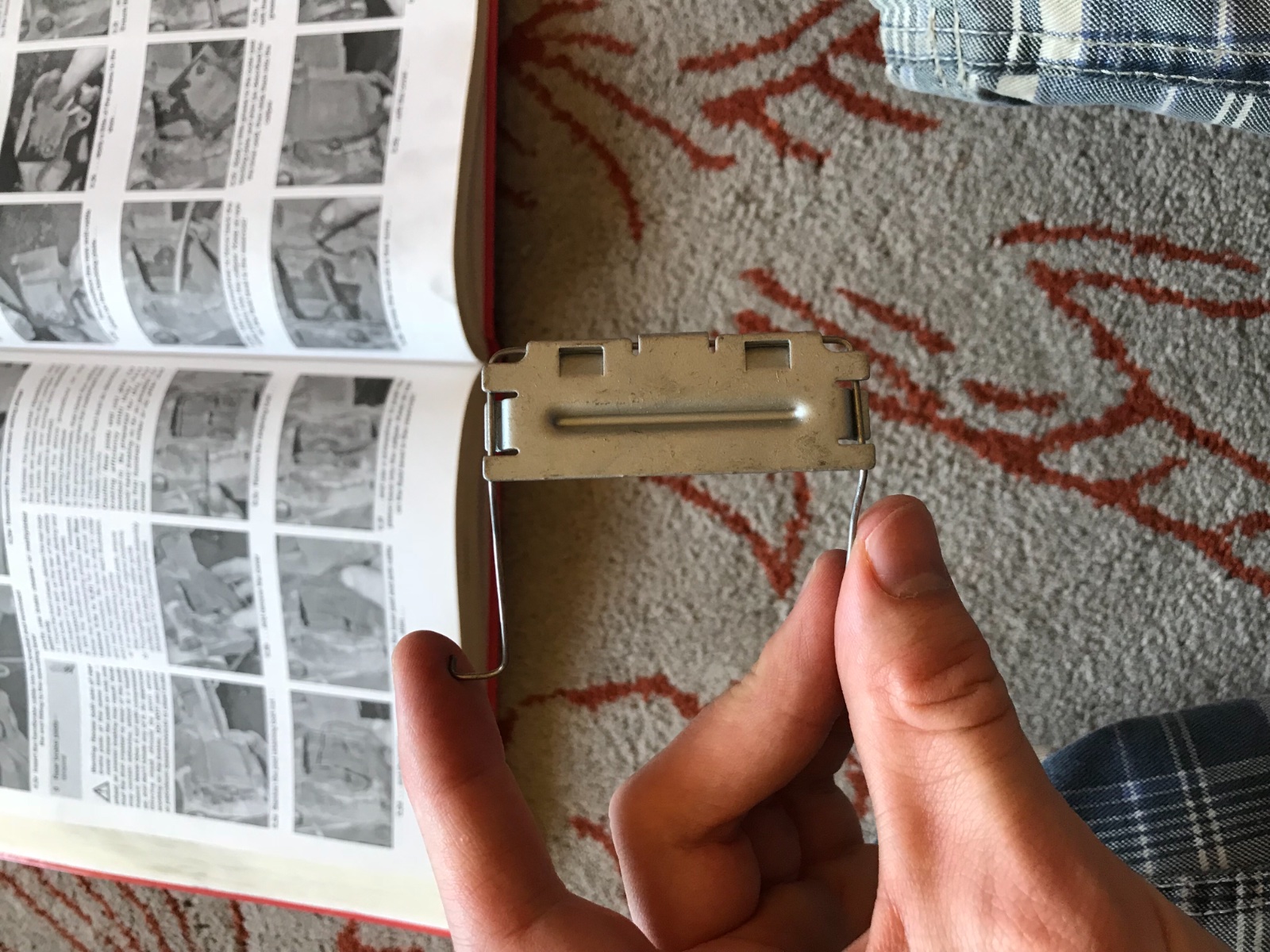

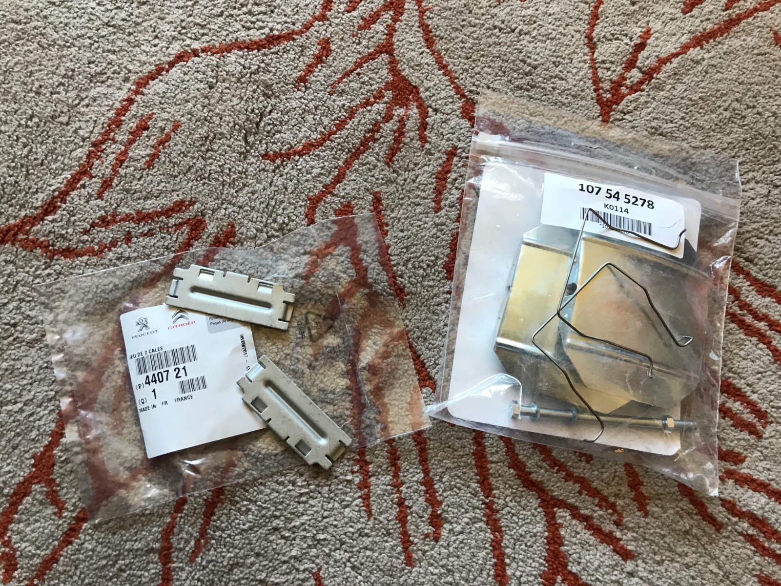

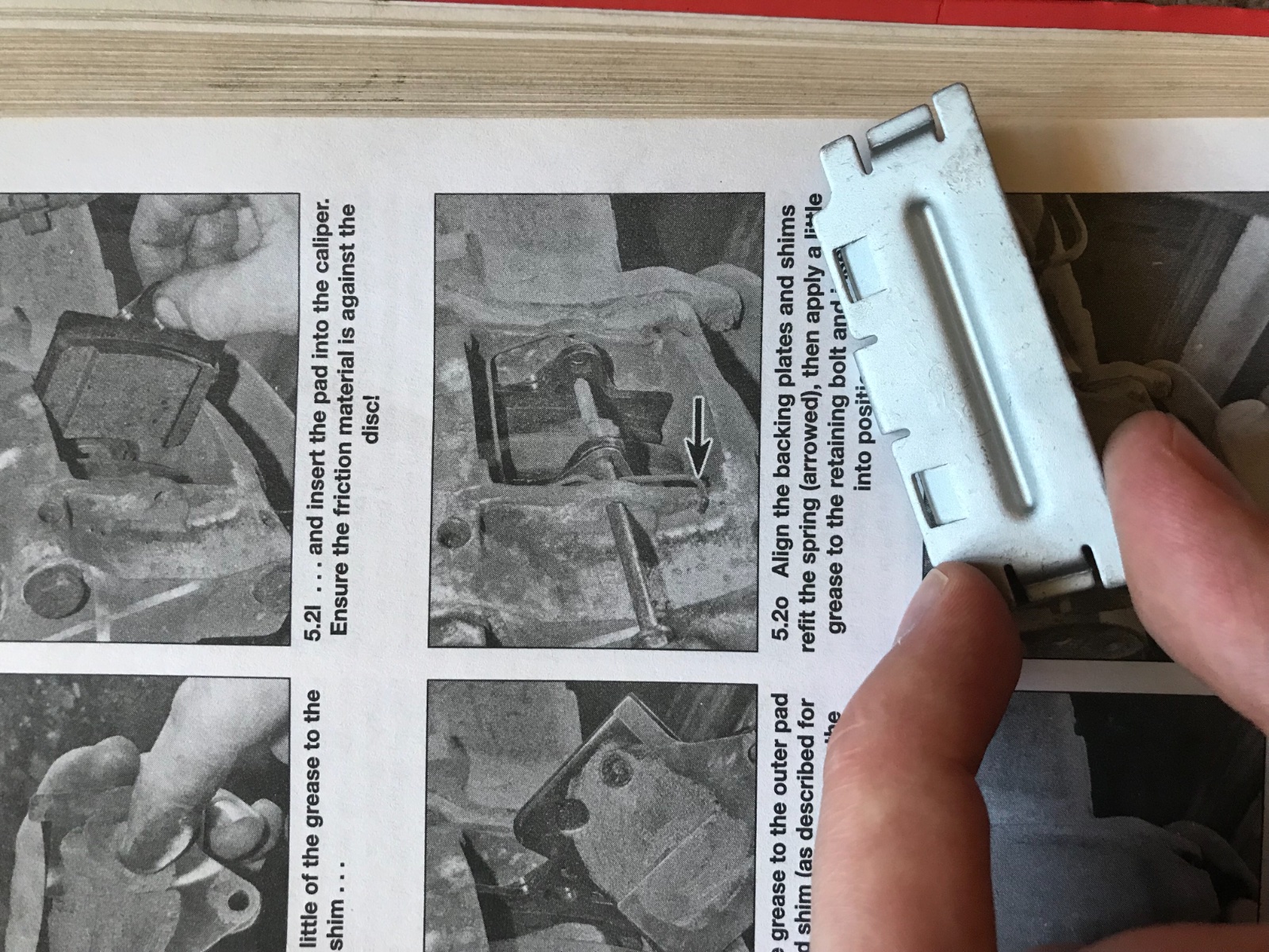

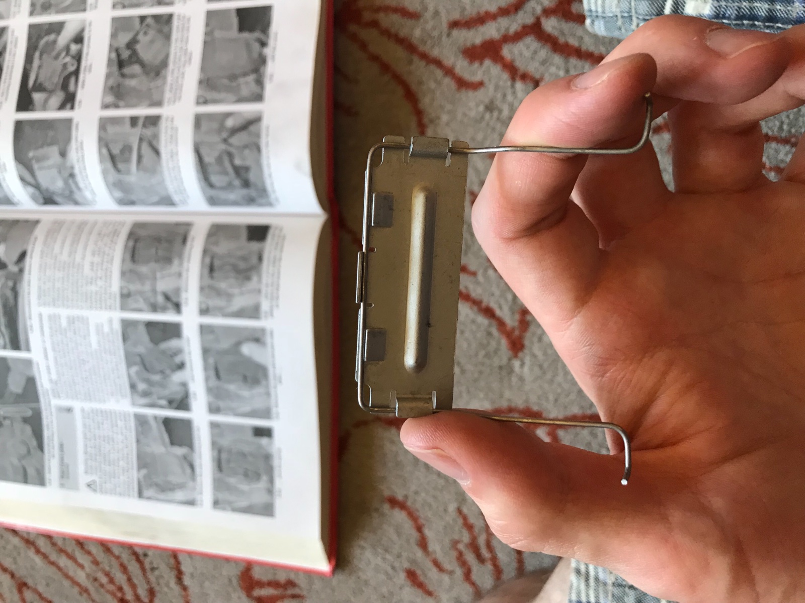

So I ordered some from Citroen for around £20 for the pair, along with a new brake fitting kit from Euro Car Parts for a whole £9, in the hope this will stop my rear brake pads rattling. However now I have them, I can't really see what difference they'll make. See the photos below for the shim and fitting kit 'constructed'.
Am I being an idiot, I can't see how this will help anything?

I've not seen those metal plates before, maybe an addition to the x7, usually there's just the wire anti rattle held in place by the through bolt, looking at the pictures are you sure you have them the correct way round in the wire, I would have thought that the flat face would go against the edge of the pads.

The shims you're on about on the back of the pads have been fitted to every Xantia I've owned and the Mk1 and Mk1 facelifted C5's as well. They are usually reusable, but I've had a set of pads before where they were bonded to the back of the pad so obviously they weren't removable on those.
The part I'm on about is part 8 on servicebox - you can see it looks like an addition to the image.
Gibbo you might be right about it being the wrong way round, hence me asking! Can't see any info about it online at all.
