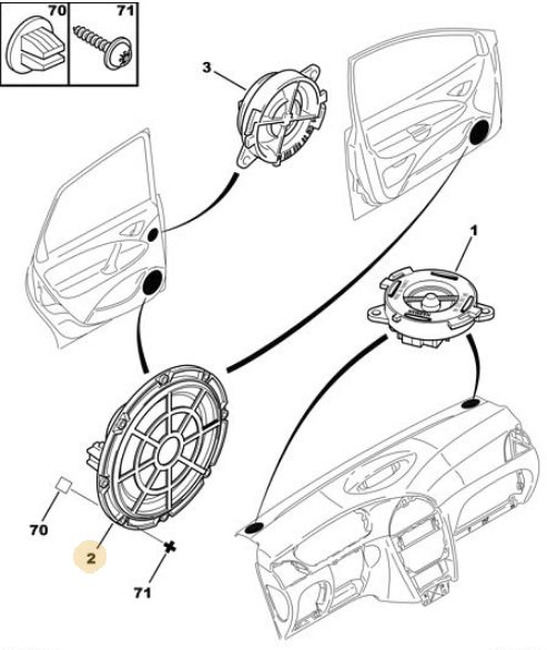

I got that same diagram when I looked up my VIN on Service.Citroen, Marc - I don't have speaker #3 in my rear doors so assumed it's the wrong drawing altogether - perhaps for the saloons?
The original speakers are made in Poland by "ASK" and the rears also have different part numbers to the fronts as well as grill colour and fitment positions.

Hi Mike - number 2 is supposed to be the correct part for both front and rear door speakers with the tweeters shown in the dash as at 1. I suspect that number 3 is / was for the JBL equaliser Amp possibly that had another speaker....
In either case, the standard ones should fit as the only other alternatives I can see under accessories are Pioneer ones that they offered.

GiveMeABreak wrote: 22 Jun 2018, 18:23 Hi Mike - number 2 is supposed to be the correct part for both front and rear door speakers
In either case, the standard ones should fit.
Strewth, call me Mr Magoo. There's a redundant lughole I stupidly used that threw out the screwholes. All four speakers replaced now.
