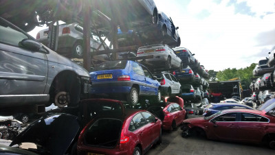

Well, that was a very useful (and massively money saving) trip to the scrappy. Both of the larger pieces, a replacement sensor pipe, and a few other bits, all for £40!!! All I need to do now is to find a PSA dealership local to me where I can get the securing bits.
They also had an X reg Xantia 2.0HDi SX and an early Saxo (so if anybody wants bits it could be worth giving them a call. If anybody wants to know more about them I took a photo (which shows their reg);
