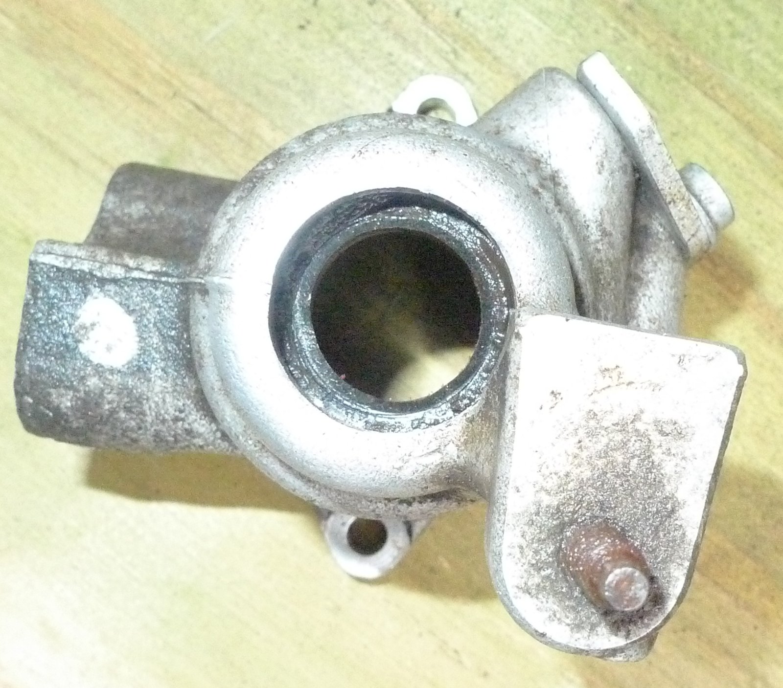

"And on the conveyor belt tonight we have...... some pictures of a dirty old pinion shaft housing taken earlier" :)
Pinion housing 5 - own work
Pinion housing 6 - own work
Pinion housing 10 - own work
Pinion housing 11 - own work
Pinion housing 14 - own work
Pinion housing 15 - own work

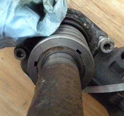

Hi Bobins, as you have the rack apart could please take a photo of the shaft side on?
Cheers
Where's the cuddly toy or did Anthea forget it!!
Stu 🏴󠁧󠁢󠁷󠁬󠁳󠁿

Sloppysod wrote: 12 Jun 2018, 17:44
bobins wrote: 12 Jun 2018, 16:17 "And on the conveyor belt tonight we have...... some pictures of a dirty old pinion shaft housing taken earlier" :)
Cheers

I've just been cooking the pinion housing as per Xantia_v6's suggestion (lightly oiled housing served with a rich jus de la Fluide DA, in case anyone was wondering :-D ) and the metal ring and oil seal came out relatively easily once cooked at gas mark 3 for 5-10 minutes. The OD of the metal ring and oil seal is 30mm, with the ID being 20mm. The oil seal is a single lip 5mm deep one. I think there'd easily be enough room for a two-lip (R23) seal in there.

Thanks, you can actually see where the seal rubbed during its life, it is also nice to see the shaft diameter is smaller than the seal diameter, which will prevent damage during reassembly. However, I think we have been looking at the wrong cause, the seal rubbing surface is free from corrosion on the picture, if corrosion was at fault then surely the rubbing surface would be marked, I am thinking it is not corrosion but the seals perish due to them holding water in the recess on top of the housing. This also means, for future failures that just replacing the seal would be sufficient. Bobbins, are there any numbers on the seal?
I have looked at the boot I covered my shaft with and one side is dirtier than the other, the 'dirt' can easily been seen from the wheel arch and could be spray from the wheel when on the wheel is turned to the right.

If you look on picture "shaft 19" the clean part of the shaft 'within' the 8.43mm measurement is where the metal bush (the thing with the 3 holes in it in one of the previous pictures) sits, I think the oil seal sits on the rusty part to the right. I'll try and do some proper measurements later and see where everything sits.

Can I ask, what is the diameter of the housing/casting around where a boot would sit ?
Taken at the same level as the red arrow.
x 3565
Re: C5 X7 Steering Rack - Again!
The diameter at the red arrow is 40mm. The internal diameter where the dust seal sits (blue arrow) is a good old fashioned inch.
