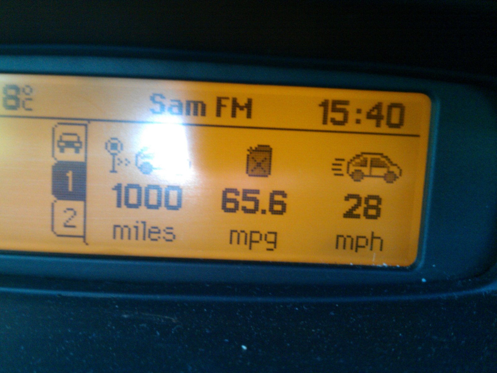

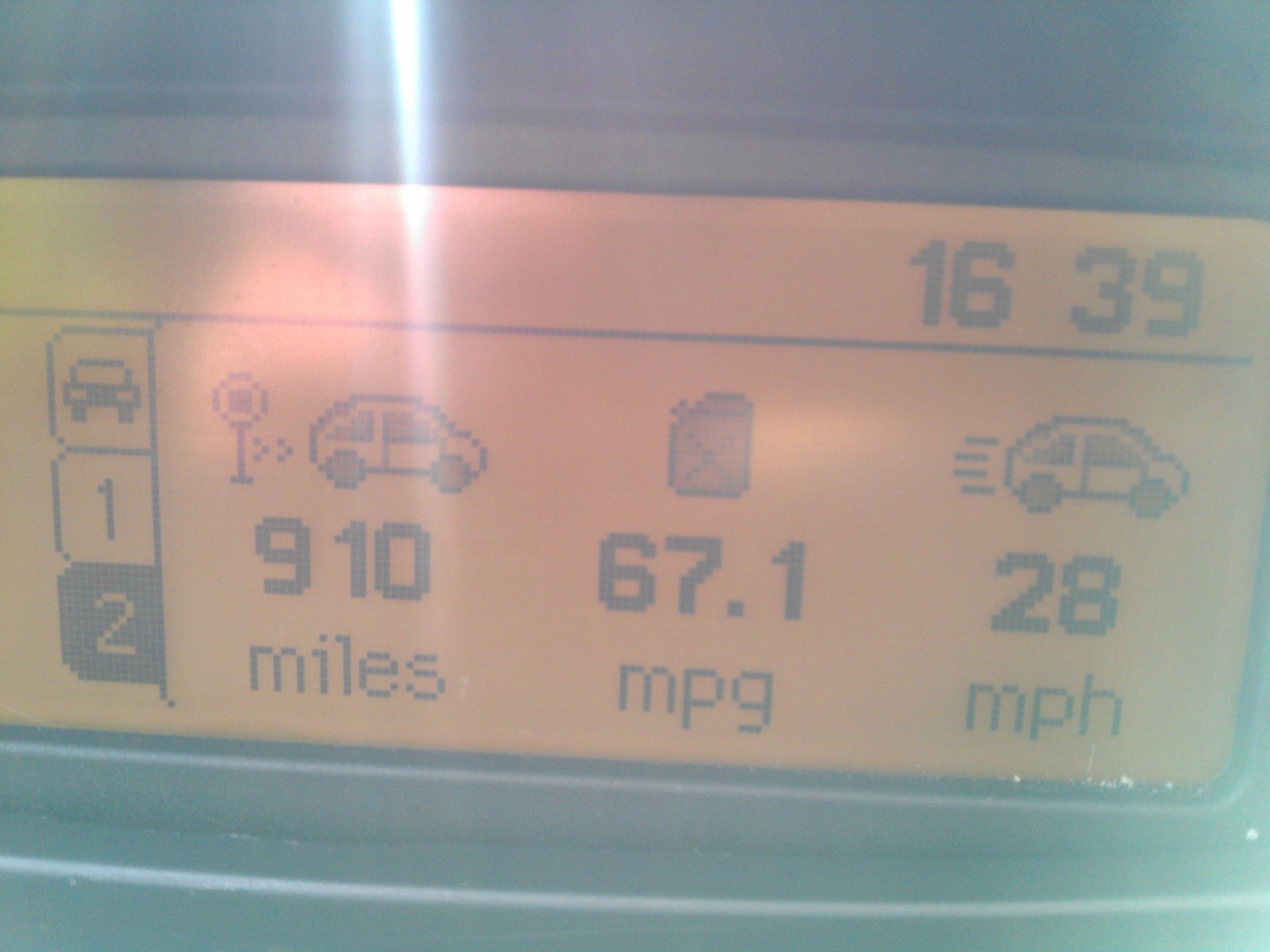

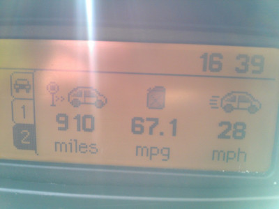

MikeT wrote: 17 May 2018, 16:12
Stone the crows! as my late further would say. :lol:
Move over counter 1, counter 2 has taken the lead... :lol:

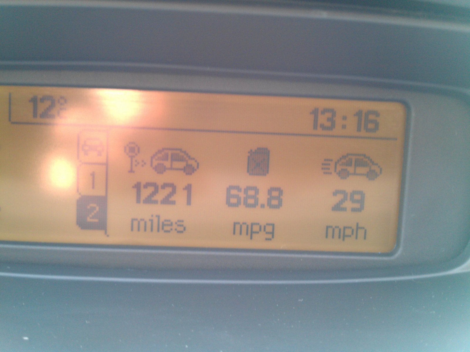

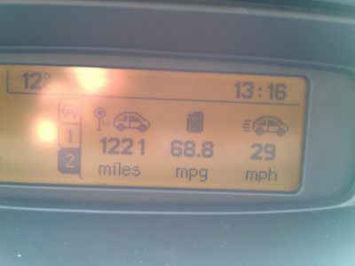

Counter 1 update to the new high of 67.1mpg shortly after.
Found a near-local fuel station that does discount days and refilled for under £1.30/L
Monitored another regen and kept it in 4th at 50/60mph for the duration at which point counter 2 updated again :shock:
