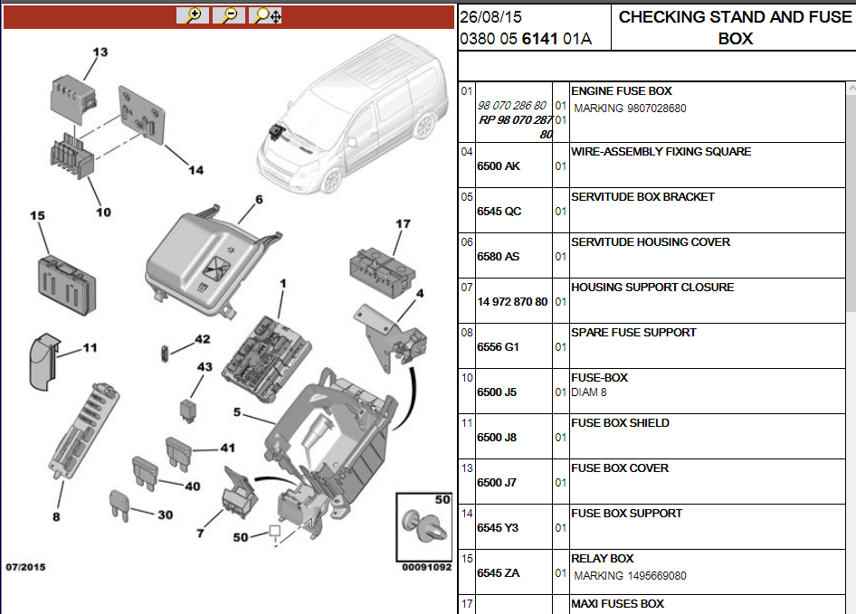

x 6960
Re: Dispatch starter removal
Rich, I would be a bit wary over that fuse box - I'm wondering if it is the right one as that part number does not come up at all for your VIN - and is not shown as any of the parts for that vehicle! I'm wondering if an incorrect fuse box has been sourced before??
Here is the part numbers for your VIN:
Click Diagram to Zoom
So you need part number: 9807028680, or the replacement part: 9807028780 if it is indeed Item 1 - Engine Fuse Box.
https://www.ebay.com/itm/GENUINE-CITROE ... Swa-dWrHI9
https://www.ebay.co.uk/itm/CITROEN-BERL ... 3143681919

Confusingly the early fuse boxes have a different number on them than the Citroen part number (which is not on the board anywhere!). If you buy a S/H one, then best to go off the number that is actually on the board. Unfortunately that is one of the expensive ones at nearly £220 so SH is going to be your friend I think. Looks in those links that the later one does have the same number on it as the Cit part number....!
x 6960
That's why I thought it might be from another vehicle, possibly having already been replaced once before. :-k

Marc, I was going to ask that, the local Citroen dealer said the same, that part number does not correspond to anything, they also quoted the part number you have. All the fuse boxes look the same, exactly, dare I get one bearing a different number or not? None of the breakers I have tried have any , been on parts gateway, breaker link, and others, no one has any. I would be most obliged if someone could give me contact details for Pug?Citroen breakers in their area, can always ask them to post if the right number comes up. My local French breaker told me the part number should begin 96, but the dealer said the one ending 680
