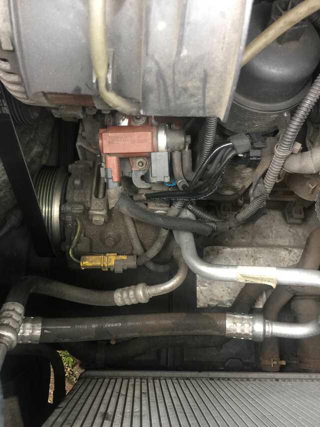

The turbo boost solenoid just under the fuel filter, it was advised on the tube as a possible culprit so it and the another solenoid underneath it were taken out and their filters were cleaned and reinstalled. To my surprised that removed the fault 2563 as well. :)
Logs were cleared, the car was taken on a run up a steep hill, power returns no more pollution faults for now :-D :-D
Unfortunately my attempts to add an image showing the location of these solenoids have failed, I thought this was shared at , but it failed when I tried to preview this post.

x 2941
Re: C5 Mk2 2.0 HDi fuel tank gives pollution error fixed
Your linked image is showing ok for me.

Good to see Gibbo that you can see it via the web link shown.
I was attempting to code it using [IMG] switches so that picture appeared as part of my reply without having to go to another website. I must read up on this, I am sure there something there in the super stickies to educate me.

I’ve uploaded your image to the Forum, which preserves it, in case of another Photobucket fiasco.
