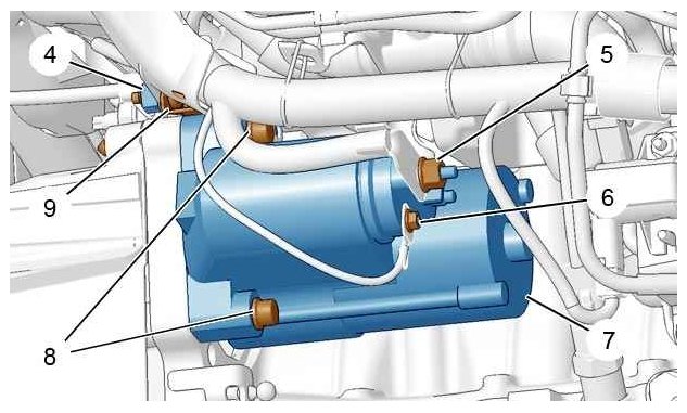

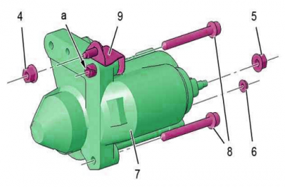

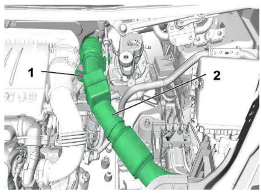

x 6957
Re: Dispatch starter removal
Ok, let's try Starter this time and not Alternator (it was a long day) :-D
So wait 15 minutes before disconnecting battery so ECUs can memorise data.
  • Disconnect the battery.
  • Place the vehicle on a lift.
  • Remove the under engine protection.
Remove:
  • The (1) bolt
  • The air duct (2)
Remove bolts (3).
  • Remove the nuts (5) and (6).
  • Unscrew nut (4) (if necessary).
  • Move aside the starter electrical harness .
Remove:
  • The 2 bolts (8)
  • The starter motor (7)
  • Move aside the electrical harness (9) support.
Refitting
Note: Check that the centring pin is present (at "a").
Refit:
  • The electrical harness support (9)
  • The 2 bolts (8) ; Tighten to 2 ± 0,3 daN.m
  • The starter electrical harness
  • The nut (5) ; Tighten to 1 ± 0,2 daN.m
  • The nut (6) ; Tighten to 0,5 ± 0,1 daN.m
  • The nut (4)
Proceed in the reverse order to removal.
  • Tighten the bolt (8) to 2 ± 0,3 daN.m.
    Refit the under-engine protection.
There you go! :-D
