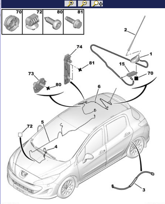

Yes, it is 308, but not 308 T9, so can you confirm that part 15 is FM2 Aerial Amp for older 308? And any thoughts about additional connector, besides fakra? Why would it need one if the radio is providing power?

Ok so standard 308:
(15) Radio Aerial Adapter for:
RD4, NG4, RNEG, Dual Radio Tuner, RD45
The Looms (4) & (5) have 4 variations according to options.
