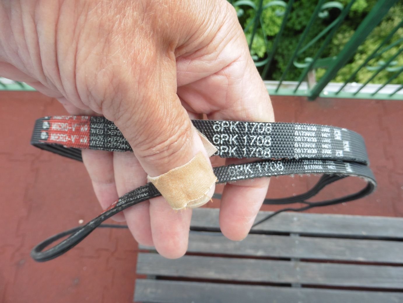

Are Gates kits of good quality ?
Gates Drive Belt Set K016PK1708
Gates Timing Belt Kit K015528XS
I recently replaced the drive belt but it has shredded again, so I think the pulleys must require replacing as they were a bit suspect : )

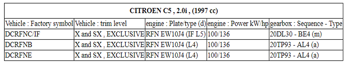

EW10J4 is the engine type Spiff. It will be one of the bottom 2 - check your engine VIN plate for the exact one.

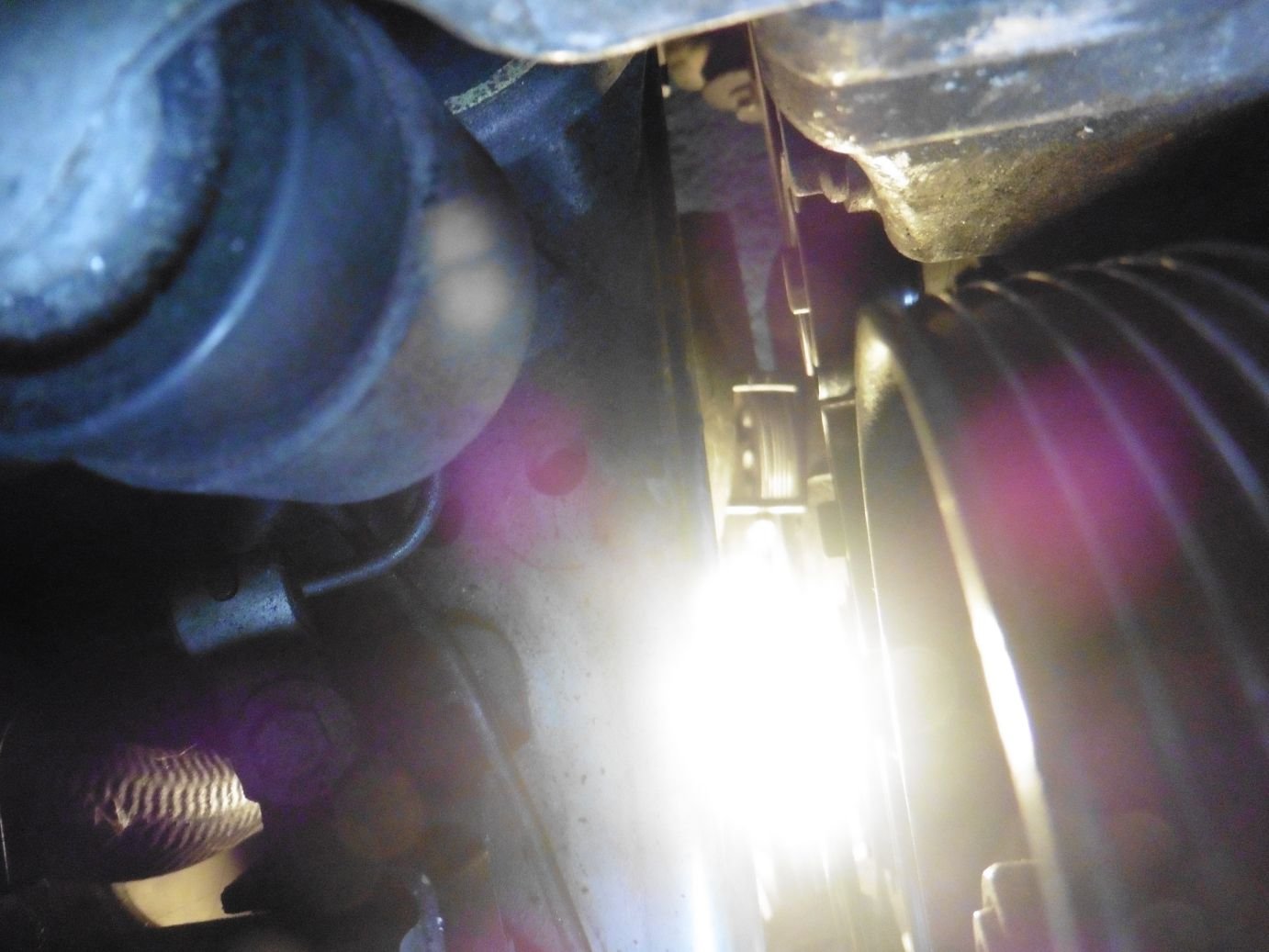

The inside wheel arches are not off at the moment.
Looking down from inside the engine compartment with a small mirror on a telescopic handle, there is a pulley at the bottom with groves for the alternator / steering pump / air con drive belt.
It has four small bolts and a larger one in the centre.
Is there also behind it the cam belt drive pulley ?
So is this the one being referred to ?
If it is the earlier version engine then from your posts I can use drills to lock the pulleys.
Other wise it will be necessary to order a proper locking kit.
I not sure where to look for the engine VIN Mark, I have the car vin, but now believe from your post that this is another vin ?
UPDATE
I can see now that the pulley is the four blot one by consulting the Manual and in my picture you can see the small mirrow showing the pulley : )
So I have the four bolt pulley and can lock it with drills is that correct ?

Yes, you can lock it at the crank pulley.
If it was the single bolt the crank locks at the flywheel instead.
