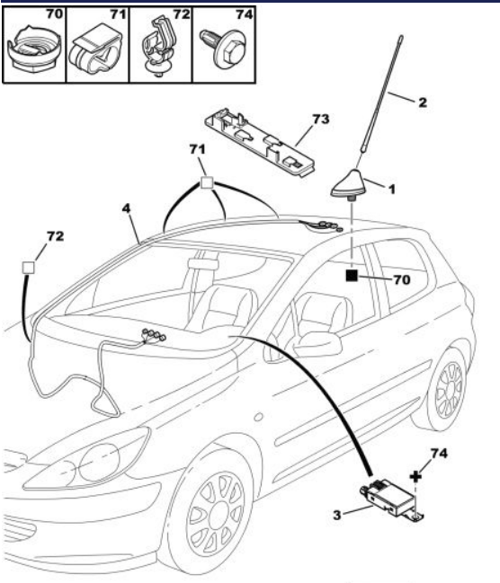

So this is a 2006 model! I'm surprised it is working at all / that you can configure this to your car using PP2000 as RT6 was not available back then. You have an older COM2003 module, and the RT3 screen was fibre optic so I assume you've changed that too? At least you have a CAN CAN architecture, this will be interesting.
Here is your current setup - the current RT3 aerial / GSM / GPS aerial is routed directly to the base unit on the roof. That aerial adaptor is NOT fitted to your car with that option as the RT3 system. The base aerial is already amplified, so I'm not sure how that will work in practice.
A more compatible system would of been RT4 that was an option for this year on your vehicle I believe.

I pulled the diagrams for a standard RT3 on the OP's car with all original options as per VIN and the picture below is the part in question Mike:
| 8454 is the Amplified + switch command 8406 is the electric aerial module (they mean powered not as in retractable electric aerial of course |
mara-
- Posts: 70
- Joined: 26 Feb 2018, 19:05
- x 7
Re: RT6 FM2?
So, let's assume that FM1 is still powered through coaxial cable. That leaves FM2. Could you look 308 with RT6 for example, to see what is done with FM2, since 308 is similar to 307 facelift? Thanks for your help so far.
