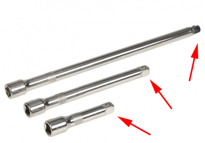

It can get stiff because of the crud that accumulates in there - what you need to do is get some lubricant in and around the plastic mechanism, but if you have a socket set you will find the extension bar is perfect for getting into the square hole and turning it. Once loosened just lube it up and it will be far easier to undo next time. :-D
