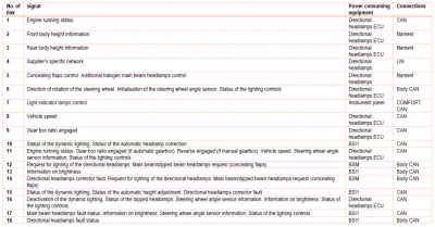

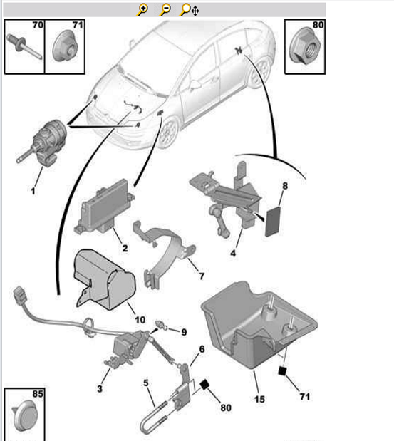

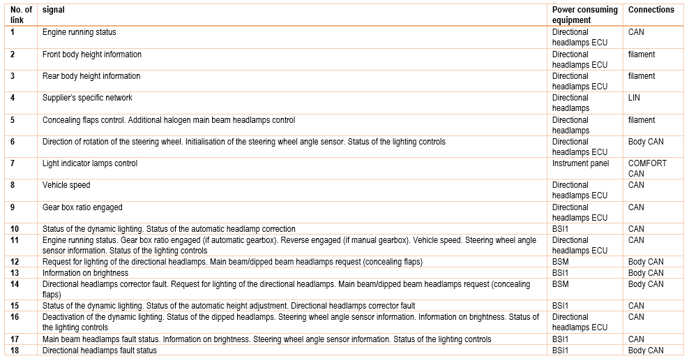

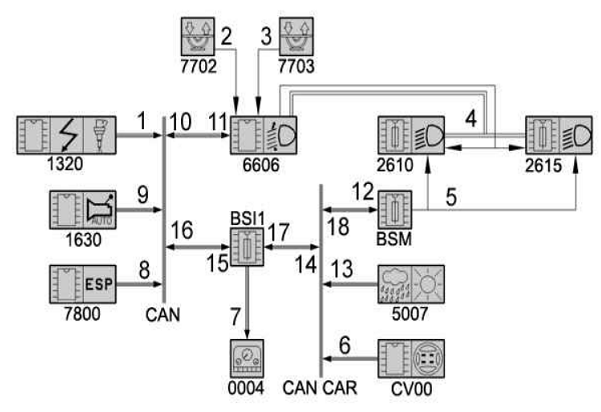

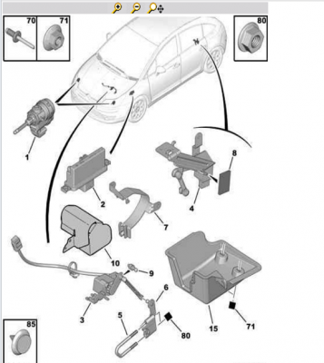

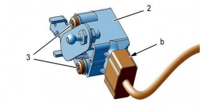

The system has it's own Headlamp ECU and communicates via these other components shown below to operate the system correctly - they all need to be in place for the system to work. You would need front & Rear height corrector units fitted to the axles as shown below, plus the car's ECU would need to have the car vehicle reference heights programmed to operate correctly. You would also have to have ESP on your vehicle and the everything in the diagram fitted and configured in the BSI and various ECUs.

| Component Table | Component Interaction |
| Interaction Diagram |

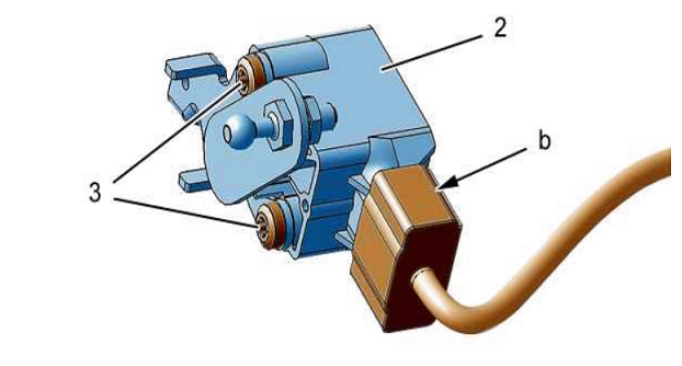

| Example of a Height Corrector Control | Headlamp Height Correctors and Fittings |

It is possible that there is a sensor mechanism attached to the anti roll bar for those cars fitted with Xenon headlights. I was looking into fitting similar to my C5, and there is clear mention of a separate level sensor specifically for the headlight system.
- x 6947
Re: Change headlights on Citroën C4 2005
The Height correctors are the same James - there are no separate ones for the directional lighting (which the C5 Mark I never had - only non-directional until the C5 Mark II onwards).
Similar connectors are used on non C5 / C6 models to relay the height information to inform the headlamp ECU - on the C5 / C6 they also communicate with the suspension ECU as well as the Xenon Directional lighting ECU where fitted.
