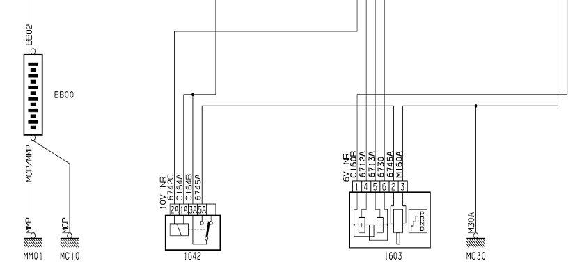

Pete I don't have your VIN, so this is based on an early X7 Auto with DW10BTED4 engine - should be the same. Now you know the location, you should be able to identify the connector to the correct relay.
Click to Zoom
Click to Zoom
| 10PR is the main harness which goes into the glovebox area |

Thanks Marc. Very useful. The item 1642 is clearly the bit I'm after but is not the part number - seems to be the wiring harness reference number. Just looking at it it would appear to be a pretty standard 4 pin relay. But my old - and possibly incomplete - Citroen Service doesn't show anything. Could you give me the part number? My VIN is VF7**************[VIN obfuscated, can be read by forum staff].

It's a generic SPST 4 terminal relay. I don't remember the part number off the top of my head but it's installed in a block with a couple of other identical ones.

I think it's a pretty standard relay - there are no part numbers that I can see apart from the buzzer and flasher unit relays - so best to remove it and id it, or see if Elis can remember where he got his - but I would suggest you replace it with the same power ratings.

Looking at the diagram showing relay 1642 it does seem to have 5 terminals - just that one is not used.

Yep, there is a high current 25 amp NC contact and 10 amp NO contact on that 5 pin relay.
