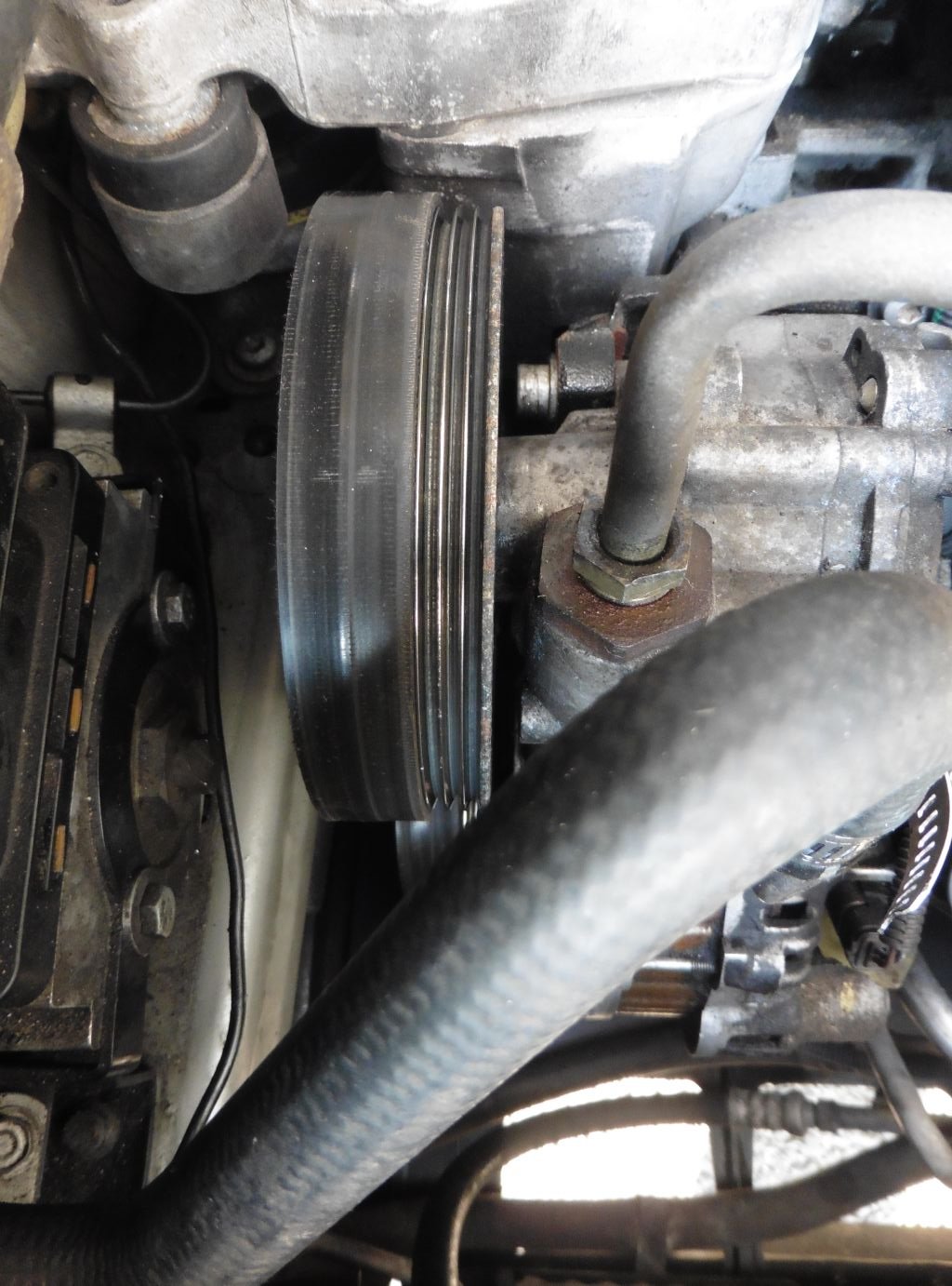

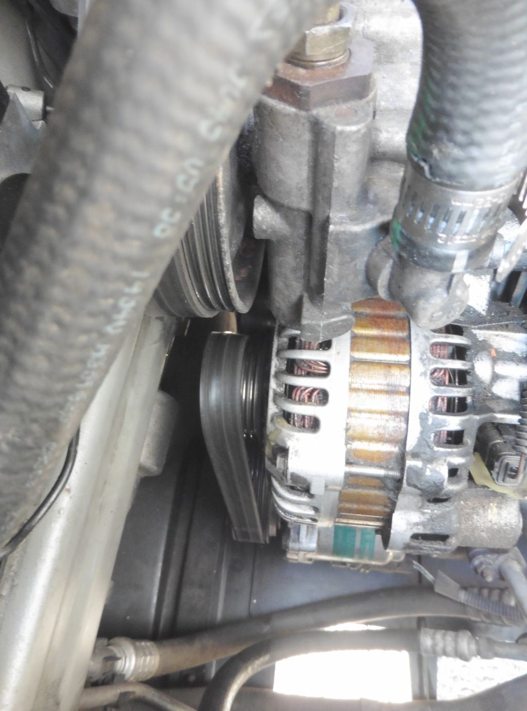

For some reason the drive belt for the steering pump, alternator and air conditioning pump has jumped three groves : )
This on both the steering pump and the alternator, but not the air conditioning pump, it is sitting ok on that one.

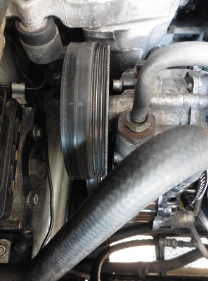

The belt feels tight and as far as I could feel still had its teeth.
When I did the pump I noticed that the tensioner wheel has a bit of play in it.
We shall see tomorrow.

The tensioner has a bolt that you turn against its spring, then release to re-tension, it is difficult to see how that could be wrong as it is automatic in the way it works ?
Perhaps something seized up momentarily, causing it to pull against the tensioner and making a loop in the belt for a second ?
I remember the idler wheel did not look quite in line to me before and after fitting the pump, but as the belt had been running OK before the steering pump failed, I assumed it would continue that way.
The steering pump looks to be in line, but worth a check : )

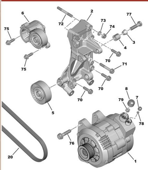

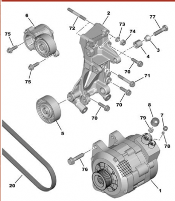

I see the fixings you mentioned Spiff -
I’ve put a Diagram up of the rollers / tensioners Spiff. Are any of these loose on your car?
Click to zoom

Thank you Marc,
That is so much clearer that the images in the Haynes manual : )
There was some squeaking, which disappeared after I fitted the repayment steering pump for the leak from its casing, I put the noise down to the faulty pump.
But just before I put the car away tonight I heard it again, though it quickly faded away.
The idler or the tensioner is probably faulty.

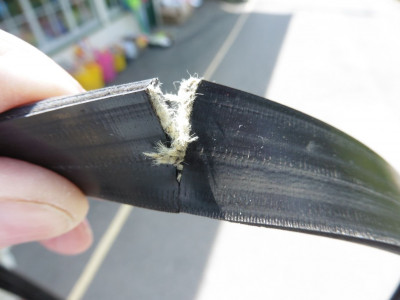

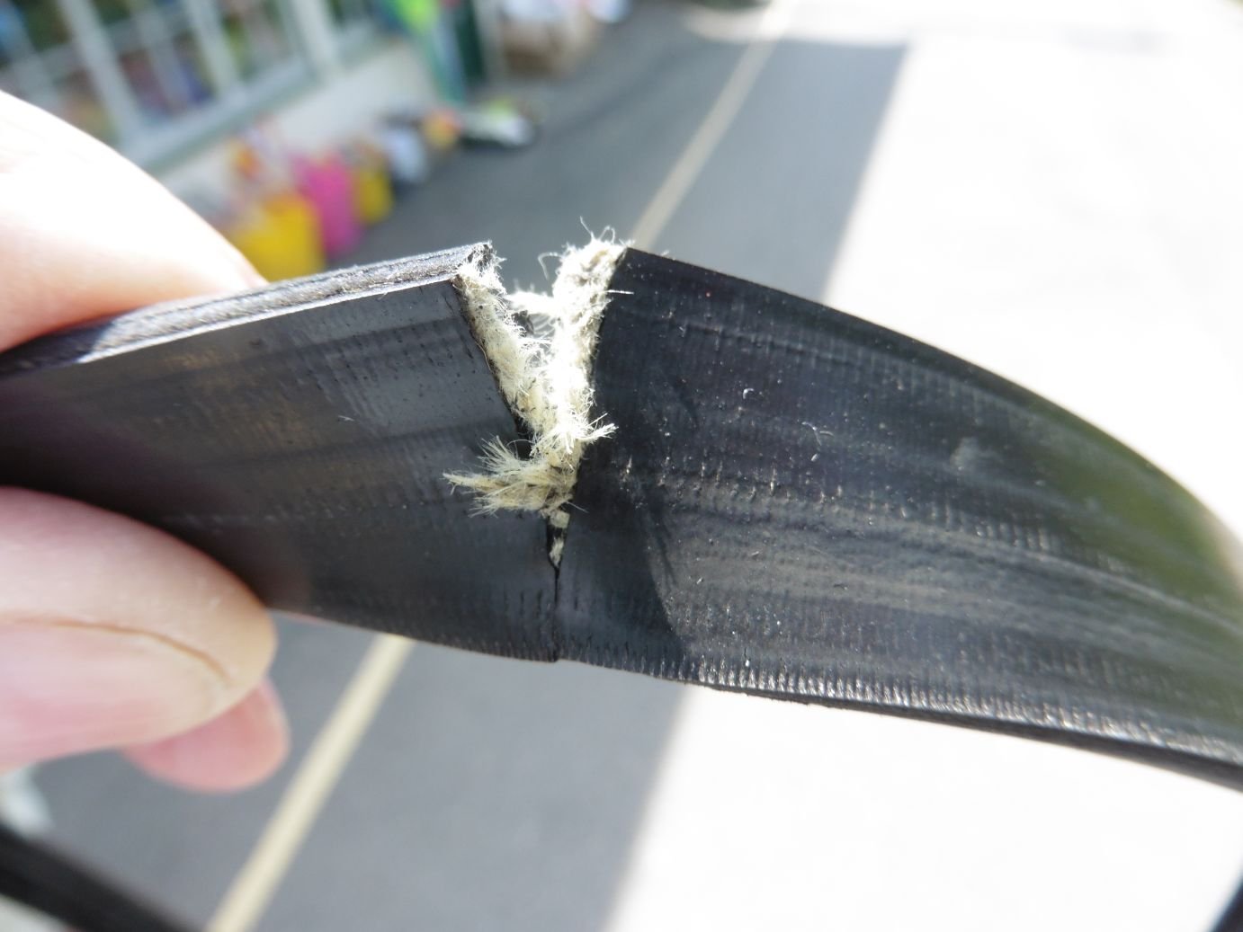

The belt came off as I pulled out of the garage to turn the car round.
Oh Boy hard going getting in in straight without power steering : )
The belt is cut halfway through, a passing tourist suggested staples and super glue : }
I have yet to look at the tensioner and idler.

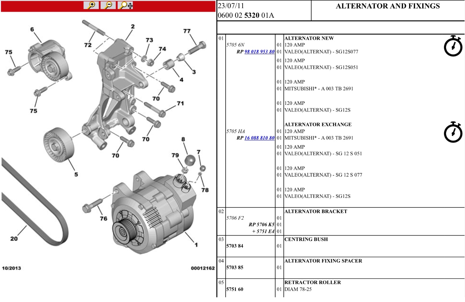

Alternator Drive Belt: Item 20: Part: 5750YA (Citroen - £41.09) or 1612164080 (Alternative - £19.75)
Retractor Roller: Item: 5, Part: 575160 (Diameter 78-25) - £19.12
Aternator Tensioner Roller: Item 6, Part: 575161 - £98.18
All the above are Citroen Genuine parts inc. VAT excepts where alternates are specified.

I wondered if the belt splitting was caused by it jumping pulleys, or if it split and that caused it to jump ?
The bearings on the alternator, steering pump and drive pulley are all fine.
There is a small amount of play in the tension pulley, but not in the idler, though it is a little out of line and has been for some time.
I will check the alignment again, thank you for that advice : )
