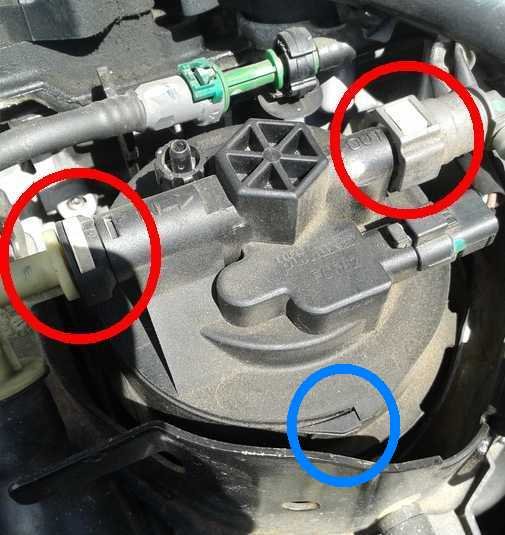

I think I'd be looking first at the little push-clip fixings (circled red) for the fuel pipes where they enter the fuel filter. These are the ones where you depress the coloured 'tag' and the pipe spigot then pulls off the filter fitting. They've always looked like a bit of a weak point to me. Check they are attached straight and level and not pulled at an angle.
Your filter may vary, but the pipe fittings (circled red) will basically be the same.
Also check the filter is fully tightened - the two parts circled blue should be touching which shows the filter has been tightened up properly.

Cheers, Guys,
Probably the connectors circled in red, they seemed very loose the last time I changed the filter so I put a tie wraps around them to make sure the white bits did not fall out !!
Ouch!....New pipe (filter to Pump) = £36, New Filter Housing £90
