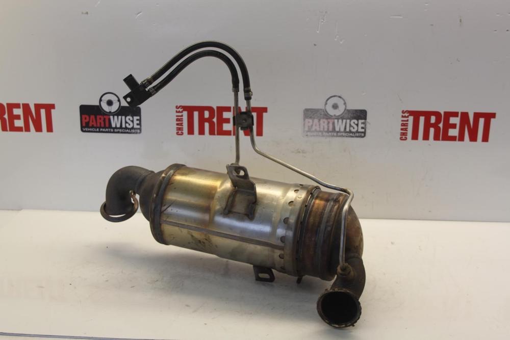

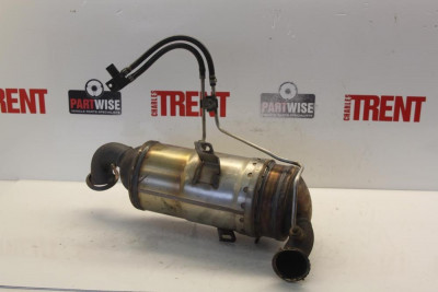

Follow the two thin metal tubes from the dpf, they lead directly to the differential pressure sensor.
It uses the two pipes, one before and one after the DPF filter material to determine the pressure drop and therefore the degree of clogging with soot.

EDC5 wrote: 13 May 2018, 10:34 Follow the two thin metal tubes from the dpf, they lead directly to the differential pressure sensor.
This isn't the same dpf as fitted to your car but you can clearly see the pipes terminating in the sensor:
