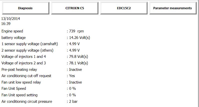

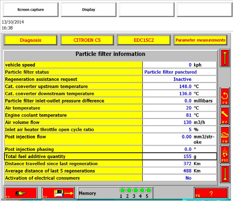

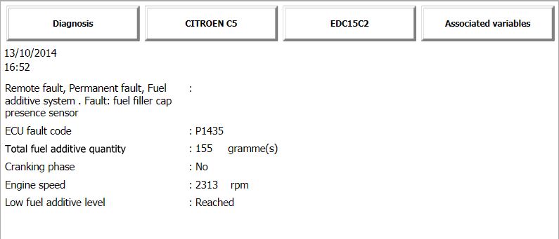

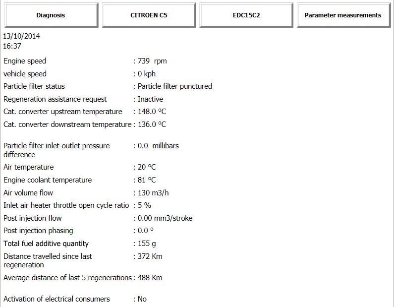

Well I am getting furstrated now, I have been searching online for about an hour! and there is no info of where the differential pressure sensor is located on the 2.2HDi engine
Does anyone have a clue? as there are so many vacum pipes going to various sensors in the engine bay?
Below are some screenshots of the Lexia Diagnostic screen, the additive level keeps increasing gr by gr, it was 145gr a few days ago... and now creeped up above 150gr, have no clue what that is, but I cannot imagine it would have perished after 20.000 miles?

Exhaust gas pressure sensors (from which the differential is calculated) would be screwed into both ends of the particle filter. Diagram shows what looks like steel tube couplings (when I would have expected signal wires) that meet alongside the front sensor and are bracketed together.kentc5 wrote:Well I am getting furstrated now, I have been searching online for about an hour! and there is no info of where the differential pressure sensor is located on the 2.2HDi engine
kentc5
- Posts: 227
- Joined: 25 Oct 2012, 22:27
- x 1
Re: 2.2HDi Fuel Cap Sensor How to?
These are the pictures of what I get when I look for 2.2HDi pressuse sensorMikeT wrote:Exhaust gas pressure sensors (from which the differential is calculated) would be screwed into both ends of the particle filter. Diagram shows what looks like steel tube couplings (when I would have expected signal wires) that meet alongside the front sensor and are bracketed together.kentc5 wrote:Well I am getting furstrated now, I have been searching online for about an hour! and there is no info of where the differential pressure sensor is located on the 2.2HDi engine
And this is what the haynes manual has for the 1.6HDi and the 2.0HDi
They both appear to operate with vacum
so you suggest that it would be under the car , instead of the engine bay area?
