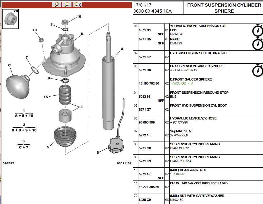

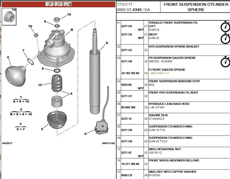

GiveMeABreak wrote: 13 May 2018, 22:32 He does not have hydractive 3. The part numbers I have given him are correct for his car. I don’t see the problem.
The code you supplied him is for Hydractive 3 + , 5271.H8
http://www.lizarte.com/en/SUSPENSION-SP ... -0100.aspx
This is for cars with a 3 sphere configuaration , and the center sphere must also be changed for giving the soft ride.
For a 2 sphere configuration, the correct code is 5271.G4
http://www.lizarte.com/en/SUSPENSION-SP ... -0103.aspx
Xantia Estate 1999 2.0 HDI 110
C5 2005 2.0 HDI 138
Nissan Leaf 2018 40Kwh
x 6948
Re: C5 Spheres on eBay two for £45 + £8.50 postage ?
Not according to the VIN for his car! He does not have hydractive 3+. That’s another reason why we ask for the VIN, it saves countless posts that are unnecessary.
I am fully aware of the differences between the 2 systems Aneesh.
Other manufacturers can put what they like down, they are NOT the official parts from Citroen. Further, Citroen may use certain spheres for different models as needed, but that part number is correct and does not mean it is only for H3+ cars. This is the problem going off other manufacturers catalogues and why they should not be taken as correct in all cases.
@ Spiff: don't forget to order the seal (5272 15) if it is not already supplied. As you can see, part number is as I have specified direct from Citroen Service from your VIN.
Sphere - item (3), Seal - item (7).

I didnt see the OP supplying the VIN number here in this thread, hence the confusion!
I agree with you in theory. If you are buying from Citroen dealer, then you must use the original part number. But if you are buying from remanufacturer, in this case the OP specifically mentioned Lizarte, it would not be prudent, to ignore their own catalogue. Because their part numbers clearly tell their sphere numbers depending on whether the car is hydractive+ or not and the engine/model numbers. In that case the catalogue of the remanufacturer should be the only thing to consider, or you end up with the wrong sphere (although because of incorrect OEM reference number used by remanufacturer).
GiveMeABreak wrote: 14 May 2018, 09:36 Not according to the VIN for his car! He does not have hydractive 3+. That’s another reason why we ask for the VIN, it saves countless posts that are unnecessary.

I once again warn you, do not just go by Citroen part number if you want to buy from a remanufacturer.
The picture posted by "Givemeabreak" shows 5271H8 which is indeed the correct part number for citroen. But do note that it shows a 52 bar pressure (presumably for non-hydractive, 2 front sphere configuration).
The link that you point to is Lizarte 20.00.0100 which is 44 bars (for a hydractive car, which needs a third central sphere). Although the reference number mentioned there is 5271.H8, it is incorrect. If you put these spheres, it will ride very hard!
The only way you can correctly check the Lizarte sphere for your car is through their own catalogue.
http://www.lizarte.com/ficheros/ESFN.pdf
The correct Lizarte sphere for you car is 20.00.0103 (assuming that you have non hydractive (sport), with only 2 front spheres).
NOTE
Please check once again if there is no third front sphere in your car (below your engine area). In your vehicle characteristics citroen profile for your car it says "ACTIVE SUSPENSION: MANUALLY ADJUSTED ACTIVE SUSPENSION", which is different from what it says for my C5: "ACTIVE SUSPENSION: WITHOUT HYDRACTIVE SUSPENSION".
In case you do find a third sphere, then you will need to buy all 3 spheres otherwise you will never get a soft ride.
My give up!
52 Bar pressure
385 CM3 volume
No Sport Mode Button
No Hydractive 3+
No Centre Spheres

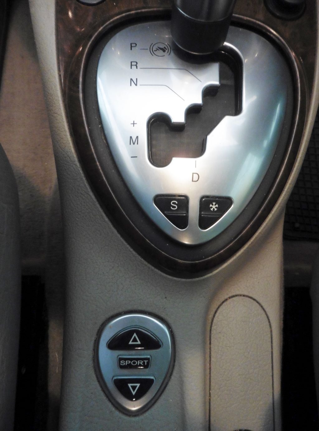

The car does have a sport mode button.
I will have a look under the front to see if there is another sphere.

spiff wrote: 14 May 2018, 18:13 The car does have a sport mode button.
Might that be sport mode for the automatic transmission, not the suspension?

The sport mode button I refer to is the lower one in the image between the raise and lower buttons.
As far as I know one of the other buttons near the auto gear lever is to slow down gear changes to give more acceleration.
Image attached

x 6948
Yes, confirmed you have H3+ now Spiff, so Sport Button on suspension as shown.
There was obviously a mix up on the VIN, so now we have it confirmed finally. :rofl2:
