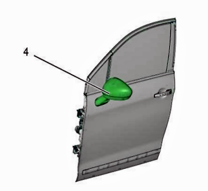

Here you go, a little more detail:
| Release and disconnect: The connector (at " m"). Unclip the clip (41); Using tool [1]. Detach: The grommet (40) (following " n"). Remove: The (39) bolt The rear view mirror (38) | Unclip the clip (1) ; Using tool [1]. Detach: The grommet (2). Unlock and disconnect the connector at "a". |
| Remove the nut (3). | N.B. : Identify the passage of the exterior mirror harness to the interior of the front door before removing the exterior mirror . Remove the mirror (4). Essential: Always replace the damaged fixings. Proceed in the reverse order to removal. Tighten the bolt (3) to 1,2 ± 0,3 daN.m. Check all the equipment works. |
| Adjust the position of the exterior rear view mirror glass (1) (At "b"). Pass the tool [1] behind the glass of the exterior mirror (1) applying force to the tool [1] (At "a"). | Unclip the fixing lugs (2) of the glass of the exterior mirror. Disengage the glass from the exterior rear view mirror (1). Unplug: The electrical connections ( as "c", "d")(according to equipment). Remove the exterior rear view mirror glass (1). Refitting Proceed in the reverse order to removal. Check the electrical operation of the exterior rear view mirror (according to equipment). |
| Remove the bolts (1). Disengage the exterior rear view mirror glass motor (2). | Unlock and disconnect the connector at "a". Remove the exterior rear view mirror glass motor (2). |
| Unclip the fixings (At "b" and at "c"); Using tool [1]. Detach: The exterior mirror shell (3). | Unclip the fixings (At "d", "e", "f" and at "g"); Using tool [1]. |
| Detach the fixing (at "h"); Using tool [1]. Remove: The half shells (4), (5). N.B.: Locate the routing of the electrical harness . | Unclip: The repeater (6) (at "j"); Using tool [1]. Detach: The repeater (6). Release and disconnect: The connector (at "k"). Remove the side repeater (6). |
| Raise: The protector (9). Remove the bolts (7). Detach - Remove: The orientation mechanism (8). | Trim Cover |
