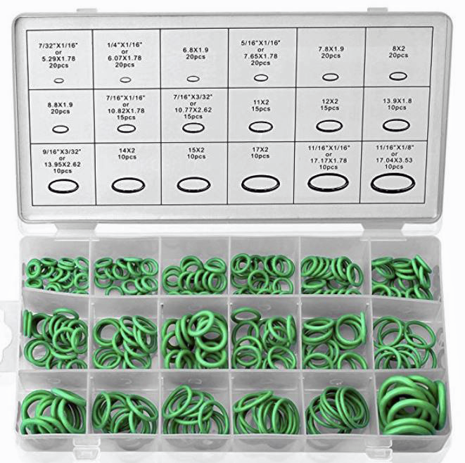

Knowing how the original ones for the rack pipes seem to leak for fun, would it be worth sourcing very mildly (as in tenths of a millimetre) oversized O rings to see if they fit and seal better ?

bobins wrote: 10 May 2018, 19:15 Knowing how the original ones for the rack pipes seem to leak for fun, would it be worth sourcing very mildly (as in tenths of a millimetre) oversized O rings to see if they fit and seal better ?
These from the land of the rising sun, have a good selection - not the exact sizes , but some
7.65 x 1.78
7.8 x 1.9
8.0 x 2.0
88 x 1.9
So not exact, but for £7.40, maybe worth a shot if the others aren't suitable.

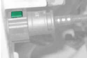

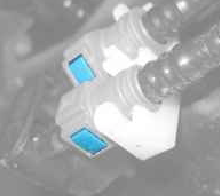

Elis - Here's my 'simplified' guide on the dreaded Eolys: Your RPO is 11656 so you should be with the Green Click Fit Unions and on the Eolys 176 the same as me :-D
On that matter without going too off topic - I just had a quote for the 3 Lt kit for Eolys 176 from Citroen - £124.16 inclusive, which includes the filling kit. I've just got to try and determine how much I need of the stuff - I'll see what Diagbox thinks tomorrow :roll:
So here is a guide I've put together:
Click Fit ColourRPODateEOLYS
WhiteTo 9492To 04/11/2002EOLYS DPX42
GREEN9493 to 1210905/11/2002 to 03/01/2010EOLYS 176
GREEN12110 to 1216504/01/2010 to 28/02/2010Infineum F7995
BLUE12166 on01/03/2010 onEOLYS Powerflex
So only the GREEN fluid types can be mixed when topping up - you must never mix the DPX42 or the EOLYS Poweflex with any other additive fluid.

bobins wrote: 10 May 2018, 19:30 If you need me to nip up to Polymax next week for anything (sample of LDS for them !?!? :) ) then not a problem as they're just up the road from work and I know where they are well.
I've just heard back and there is a min order quantity of 100 pieces of each, so although I accept that Citroen have an issue with faulty steering racks, I can't see me needing a 100 of these seals....yet!
Thanks for the offer of picking them up for me (Robin) and the recommendation (Chris) though - I'll just order a box of the mixed 'miniature incredible hulk hoola hoops' as backup.
