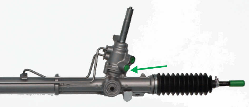

Yes, the number 2 LP pipe, apparently it corrodes. The guy reckons in almost every X7 steering rack he replaces the LP pipe corrodes where it enters the rack, if you don't replace it then it wont be long before it leaks from the pipe/seal area.
His re con racks are £295 + V & he says he can do a brand new one for £500 + V. On the recon ones the pinion shafts are totally re plated ?
In my case even though the pinion valve is extremely rusted the pinion valve seal is definitely not leaking, It's only me who has inspected it & its completely dry. Ive had the big grommet out & inspected it all round with a mirror & camera.
I will however replace the rack & pipe together as its only a matter of time before the pinon does start to leak.

Thanks for that info - I'm going down to see my indy later today for a chat - as obviously we need to confirm the exact location of the leak..
So all the HNBR O rings I can find are just huge assorted boxes from the Far East. In the Ebay ad that Robin linked to earlier, on the full description the seller says:
1 - 7.6 x 1.8mm
1 - 8.7 x 1.8mm
So should I be searching for this size in green HNBR?
There isn't anything to say these are HNBR - but the quoted sizes for the above say:Please note
For all Citroen C5 owners, I am asked numerous times if these fit the C5.
According to the Citroen dealer parts ID system the power steering rack seals are not sold individually only with the pipes, but a customer bought a set of these seals quite a while ago to try and sent me a message back saying they fitted no problem, I cannot advise they definitely will fit but I have told this to many buyers who have since bought these seals and have had no come backs.
Petrol, Diesel and Hdi Diesel Variants so please check before purchase
Peugeot Citroen part number 406631 & 400632
1 - 7.6 x 1.8mm
1 - 8.7 x 1.8mm

The ones in the eBay ad are probably silicon and are fine with LDS, HNBR are just the next step up the quality ladder. There's nothing actually wrong with what the ones in the eBay ad are made from.
When I measured my old O rings from my old rack they were near enough the same dimensions as makes no difference as the eBay ones.

So after the initial cardiac, and just back from the garage - we couldn't see anything from the pinion itself after cleaning up the area. So started her up and only then did we see a very small bubble of fluid emerging from the LP pipe seal (as far as we could see) - as it was forming from the left of the seal and then running down - so the lower of the green seals in the picture, arrowed:
So I'm going to get both a set of the older C5 seals as Robin liinked to and also a box of green Chinese specials (HNBR I hope) and they'll try and replace the seal first - as the LP pipe itself looks in good nick and no rust from the outside at all.
So in for a penny, in for a pound, I've decided to get the
- LP Pipe seal replaced and see how we go with that - (pending a replacement LP Pipe / Rack later if it doesn't work)
