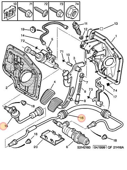

Possibly the parts are still available, they are not listed as NFP. Need the VIN to confirm, but there appears to be a short 'pipe' from the master cyl, then the long pipe to the slave:
Reference Description Quantity Price - VAT Price + VAT Total + VAT Selection
0000215619 CONTROL PIPE 1 33.37 GBP 40.04 GBP 40.04 GBP
00002156L7 CONTROL PIPE 1 3.64 GBP 4.37 GBP 4.37 GBP
L7 is the short one (15), 19 is the long one (16) to the slave.

Many thanks, that is exactly the diagram I couldn't find, it is the short pipe from the master cylinder, I hope they are still available, if you confirm the part number I'll find a friendly Citroen (or maybe Peugeot) dealer over here.
The VIN is VF7**************[VIN obfuscated, can be read by forum staff], RP 08904.

That same diagram comes up against your VIN, so part no 2156L7 is the one you want; as I say it's not showing as NFP, but.... however, it seems to be fitted to the MK3 Dispatch, so there's a good chance it's still available.

Thanks Richard for the diagram and part numbers. I ordered the "L7" pipe from the local Peugeot dealer (Citroen was closed!) and it arrived in 2 hours. Fitted and the leak is gone and all is back up and running.
I cannot see the problem with the old pipe, even under magnification I can see no hole or crack, put pressurise it on my makeshift jig and fluid appears around the swaging. I guess after 17 years and 400k miles it is a metal fatigue crack. One down to experience.
