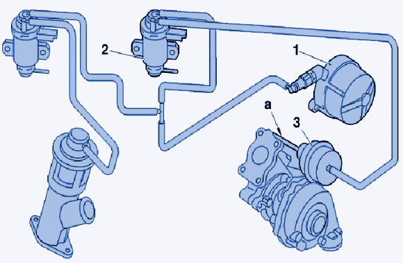

In the picture the item shown below the egr valve, looks like the turbo. Do you happen to know if : in the diagram there is a pipe that runs from the egr valve to the turbo, is this a vacuum pipe to a vacuum operated waste gate? If so do you know the bar pressure to operate the gate?

Ok, so here's the Air Circuit info that I think you are after:
Check - Vacuum Pump
Turbocharging Pressure Regulation Solenoid Valve
DW10ATED engine (which yours is)
Connect the tool [ 1] between the turbocharge pressure regulation valve (3) and electrovalve (2).
Compare the values read with those of the table below.
Pressure regulation valve
DW10DT and DW10ATED engines.
Check - Vacuum Pump
| Engine Speed | Pressure Measurement |
| 780 rpm 0,6 bar | 4000 rpm 0,25 bar |
- Connect the tool [ 1] to the valve (3).
- Apply a vacuum of 0,5 bar to activate the shaft "a" : The shaft "a" should move by 12 ± 2 mm.

Update.
Over the weekend I checked out the vacuum circuit and found a faulty turbo vacuum solenoid. The solenoid vacuum pulsed on and off rapidly under load and it made the noise that I have been searching for. So I have ordered a new one and will let people know what if any improvements it makes. Big thank you for the help and support received.

So, I have fitted the new turbo solenoid and this has stopped the noise. I have also removed the EGR valve assembly and cleaned it. Interestingly the EGR was not that coked up but it was not moving freely either. The surprise was how restricted the EGR gas cooler was. Most of the gas flow tubes were blocked, which took some cleaning out.
So the fuel consumption is now 36mpg town and around 40 mpg town and 50 mph cruise, 30 miles journey 20 town and 10 cruise. The engine feels more responsive, and climbs the rev range easier. Still need to work on the mpg though.
