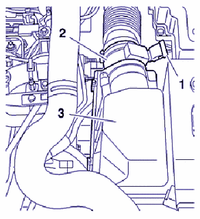

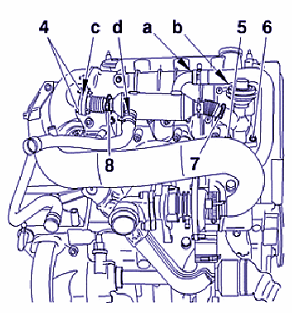

Right now I'm back in the zone, here is the procedure for removing the EGR Valve and Heat Exchanger:
Drain the cooling system.
Disconnect the battery negative terminal.
Removing
Disconnect the connector (1)
Remove:
The air cleaner (3)
The flow meter (2)
Disconnect the hose at "a".
Remove:
The nut (5)
The nut (6)
The bolts (4)
  • Disconnect the EGR valve hose at " b".
  • Lift the heat exchanger EGR valve assembly
(Note: Retrieve the seal 'C')
  • Slide the assembly towards the gearbox.
  • Disconnect the hose at " d".
  • Remove the EGR valve assembly and the exchanger.
  • On the work bench, mark the position of the component to be removed.
  • Remove the collar ( 7) or (8).
Refitting
  • Relocate the unit removed in accordance with the identification marks made before refitting.
  • Refit the clip ( 7) or (8).
  • Continue the fitting operations in the reverse order to removal.
  • Fill and bleed the cooling system

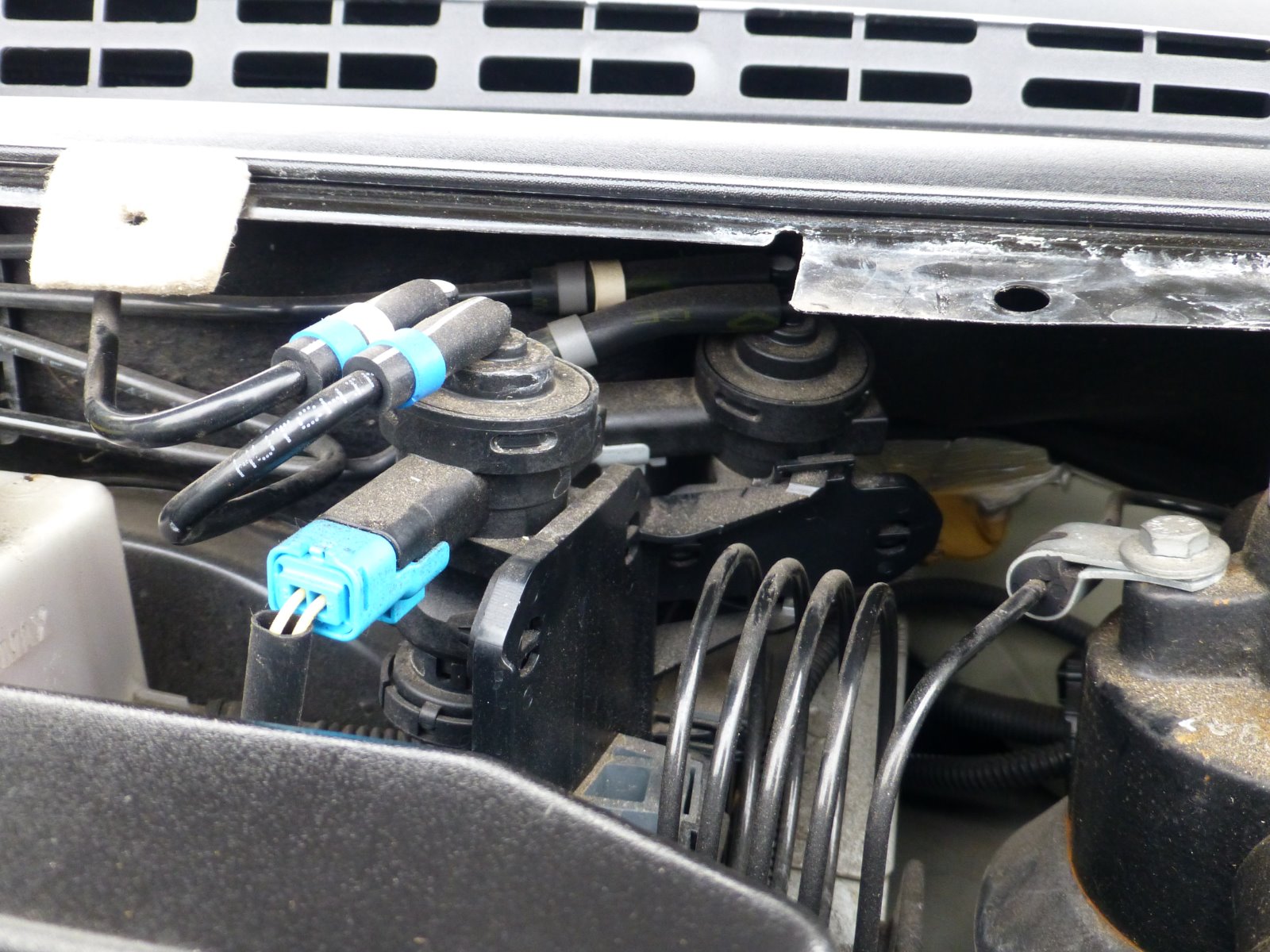

Hi could I ask for help and advice again?
I disconnected the vacuum pipe from the egr valve today and found a couple of interesting points.
There is a vacuum on the egr valve pipe on tick over, is this correct? I would have expected no vacuum at low rpm.
I sealed up the vacuum pipe and took the car for a drive to see what would happen.
Interestingly the mpg was increased by around 5mpg, the chirping noise was more pronounced and lasts much longer, the noise is there between 1500 - 2000 rpm and does not disappear in that rev range.
When I got back home I followed the vacuum pipe across the bulk head, removing the black plastic cover exposes two parts that look like electric solenoid valves, attached photo. Both of these were hot to touch.
Does anyone know if they do get hot and can they become noisy? Also can any explain what they do in the system as they appear to have interconnecting vacuum pipes.
Hope this makes sense.
Thanks

Re: Help please, poorly C5

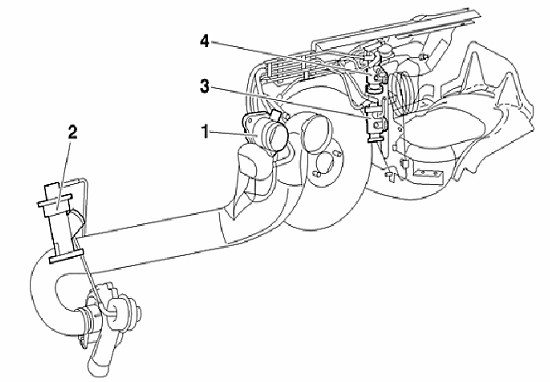

These are the recommended checks: You'll need some way to test the pressure though - similar to the tool shown (1) further down. Note the colour of the connectors to identify the relevant electrovalve discussed. Your image is identical to the first diagram below - you can see the coil of the pipes.
(1) Throttle butterfly housing .
(2) EGR valve (tube marked in blue).
(3) Solenoid valve (black connector).
(4) Solenoid valve (blue connector).
EGR Solenoid Valve
A vacuum check is to be carried out between the electrovalve (4) and the EGR valve (2).
  • Connect the pressure measuring tool as an adaptor between the electrovalve (4) and the EGR valve (2).
  • Compare the values read with those of the table below.
Engine SpeedVacuum Value
780 rpm 0,5 bar 2500 rpm 0 bar
Butterfly Housing Electrovalve
Check to be effected with all the gases evacuated between the solenoid valve (3) and the throttle housing (1).
  • Connect the tool [1] as an adaptor between the electrovalve (3) and the butterfly housing (1).

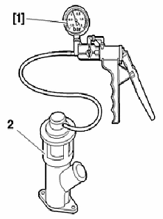

EGR Valve
Connect the tool [1] on the EGR valve capsule take-off (2).
  • Apply a vacuum of approx. 0,6 bar(s) to actuate the EGR valve.
  • When the vacuum is suddenly cut off, the valve should click as it returns to its seat.
  • Repeat the operation several times.

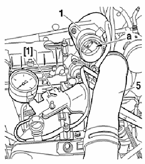

Throttle Butterfly Housing
Remove the air duct between the air/air exchanger and the butterfly housing (1).
  • Connect the tool [1] on the butterfly housing vacuum capsule (1).
  • Apply a vacuum of approx. 0,8 bar, the flap (a) of the butterfly housing (1) should be closed.
