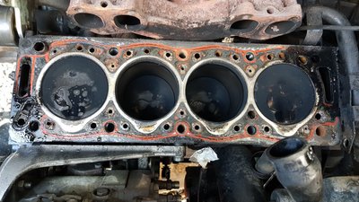

Some questions:
I watched a video of an American guy refitting a head and he used a tap of some description to clean out the threads in the block prior to installation of the bolts. Where would I get that tap?
The locating shim is not laying about on my drive as far as I can tell, perhaps lost on a previous head job? If there is one missing where does it go and can I get a new one?
The harmonic balancer pulley bolt seemed very easy to remove, what's the correct torque? Same goes for engine mounts (into the head).
Do I need to replace the timing belt? - Some oil has been dripping onto the belt area and the accessory belts,as far as I know the engine fitter put a new one on and I've only done 500 miles since then!
Loctite for cambelt related stuff - what type?
Here's a photo of the head from above with the bolts in their respective positions, one or two are quite rusty...
Posts: 54967
x 8309
Re: XUD 9 oil leak
Yes, good idea to clean up the threads with a tap. You can make one with an old head bolt by making three cuts in it with a hacksaw... You MUST replace the head bolts any way as they are stretch bolts and cannot be reused. Clean the threads out and blow out with an airline too..
I also recommend you have the head very lightly skimmed to ensure you have a god new sealing surface for the new gasket.
Crank pulley bolt should be done up FT with Loctite... You were lucky it came of without a fight!
Yes, cambelt should definitely be replaced, along with the water pump. Failure to replace the water pump is a sure way of guaranteeing it'll fail a couple of weeks later!
Check your cambelt jockeys and tensioner too... Replace if worn/noisy...
Loctite ONLY on the crank bolt as stated. Use the stuff that will come apart again ;)

I've just removed the cam, I'm a bit stuck, the injectors need to come out? They seem to be two piece?
Also, the bearing caps - they fixed on with studs? Do I just locknut and wind them out? (if they need to come out).
I was a bit unsure how to remove the buckets but when I flipped the head over for a look they all plopped out in a nice orderly fashion shims intact - phew!
The head surface seems pretty flat, according to my now twenty year old steel rule, but there's deposits and general cack on it. Hope to get it in for a skim tomorrow...
x 1751
Re: XUD 9 oil leak
The injectors come out in one piece - don't separate the two halves. You'll need to buy an injector socket to unscrew them - Halfords or a motor factor. I think the size is 27mm, but you'll need to check. Follow the Haynes instructions; it's good on this sort of thing.
Also replace with new the fire seal washer and copper washer on each injector, when refitting. Worth also getting hold of some new leak-off rubber pipe (Citroen sell a 1-metre length).
If the injectors have done upwards of 60,000 miles, worth getting them serviced - they strip, service and renew innards, and recalibrate to correct opening pressure. Here, it costs about €70 to have a set of four done. Best to go to a local Bosch service centre for this, or a good diesel specialist, who will also be able to supply the washers.
Cam cap studs in your photo will unscrew - locknuts, or failing that a mole wrench on the lower part.
Valves and head look good in your photo. If you have it skimmed, it should come back spotlessly clean.
