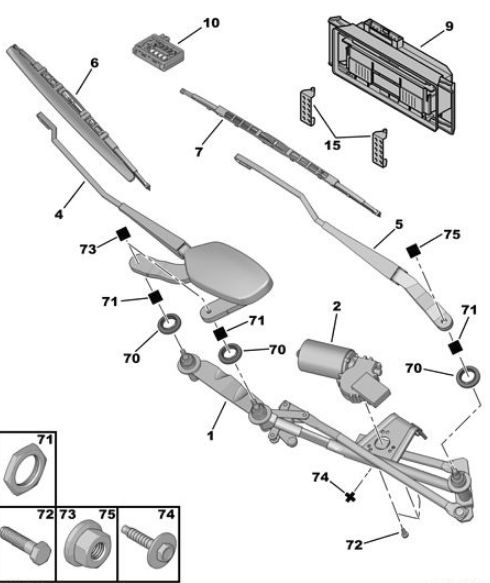

Here are the diagrams of the wiper assembly and the area showing the scuttle - which might help you with removal
Click to Zoom Diagrams

Could it be the motor broken, or would that not work on any speed if it is broken.
- Posts: 42019
- x 6955
Re: Wipers won't work on fast speed
If it was the motor - then it most likely would be stopping / starting at random spots on any speed as it is under the same load while on the car during a wipe cycle and the speed shouldn't make any difference.
